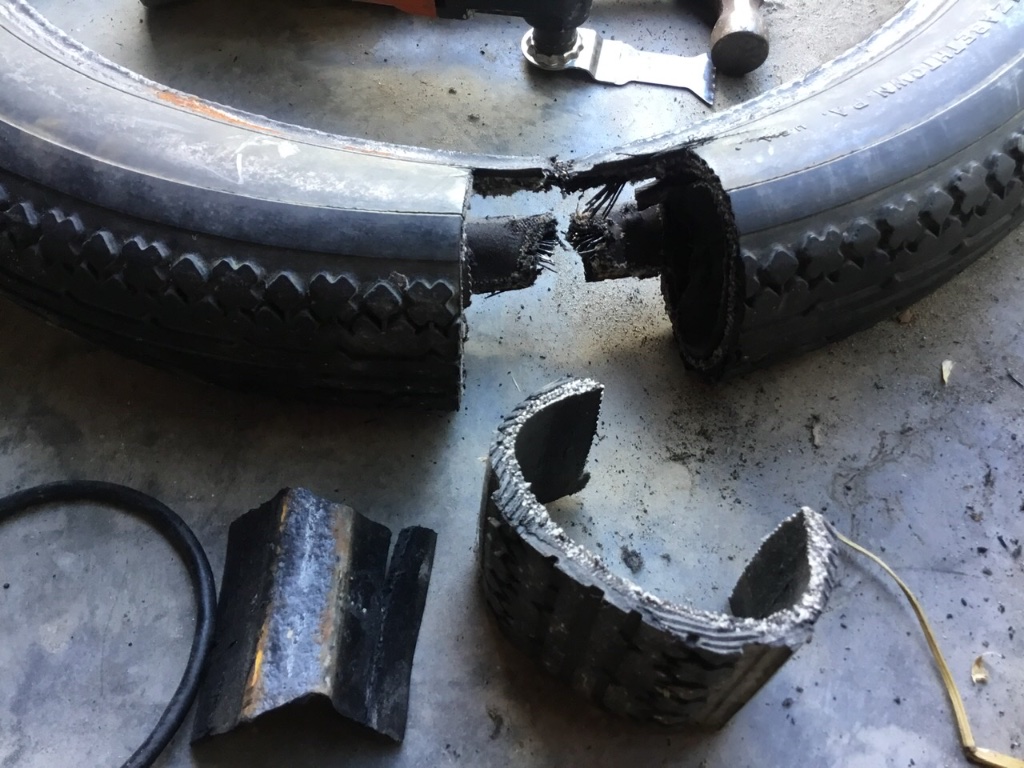

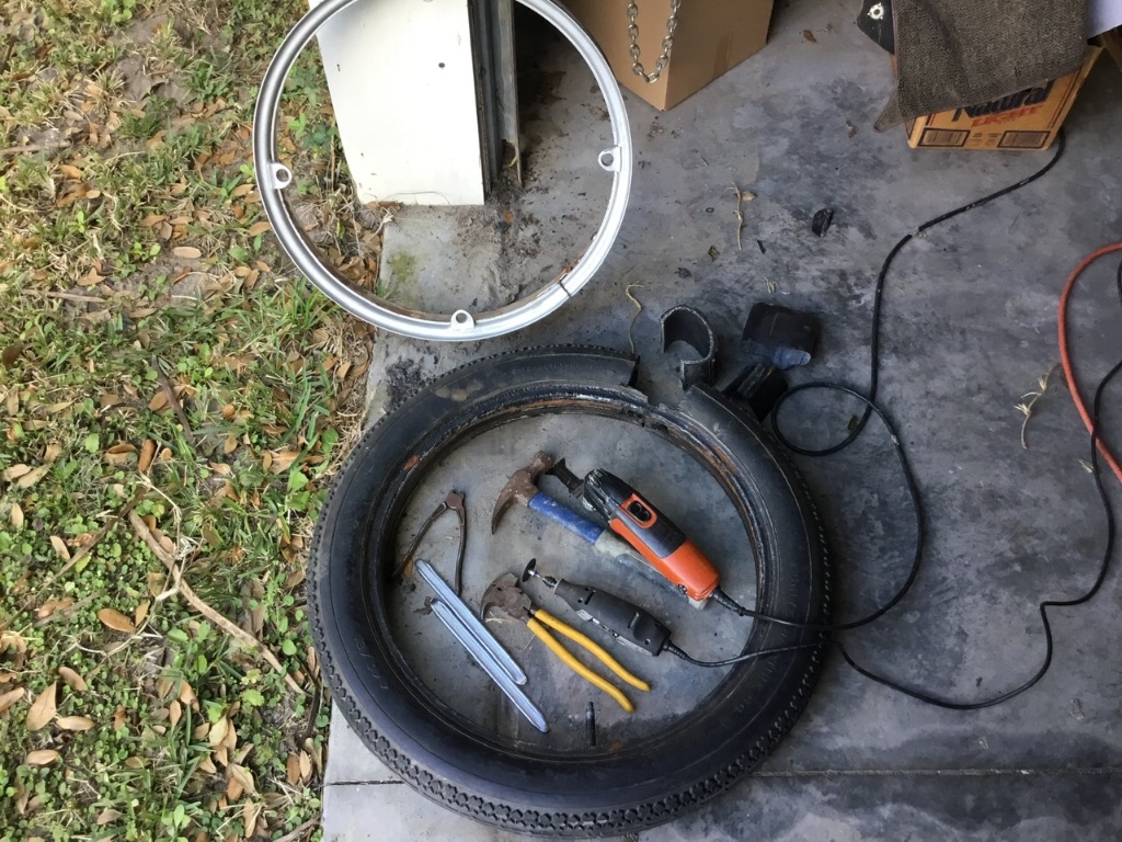

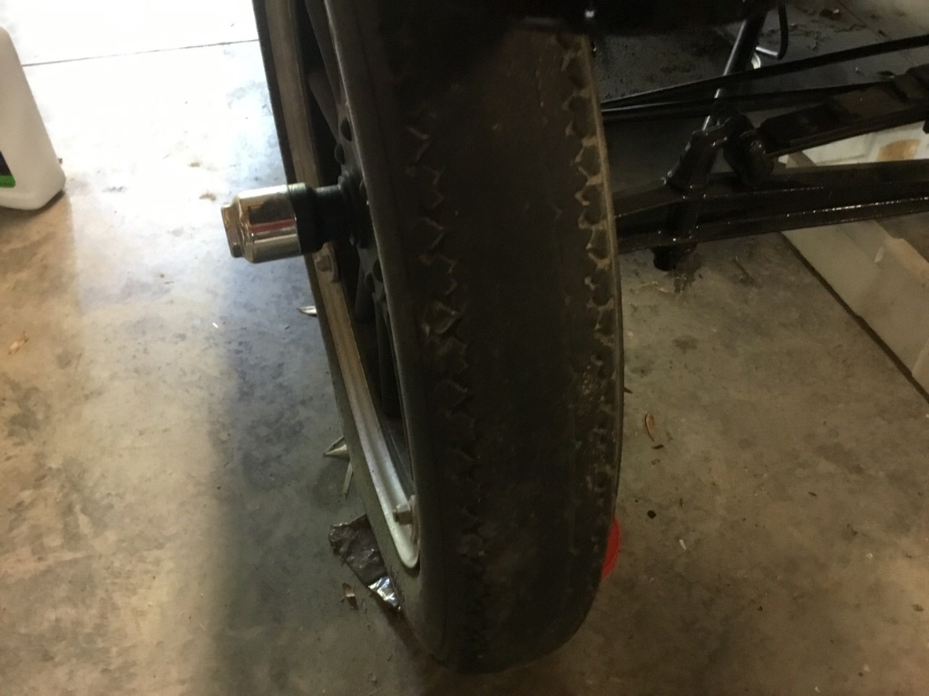

I am finally getting around to replacing my 51 year old Universal tires on my ‘26 Coupe since 1971 with New 21” Goodyear tires with flaps. Anyone ever try removing rock hard tires from rims? It is a bear! I had to cut a 4” section out of the tire with a plunge saw to gain access to the bead on each side of the rim to grind the reinforcement wires of the beading so as to get the tire off. Jim Patrick

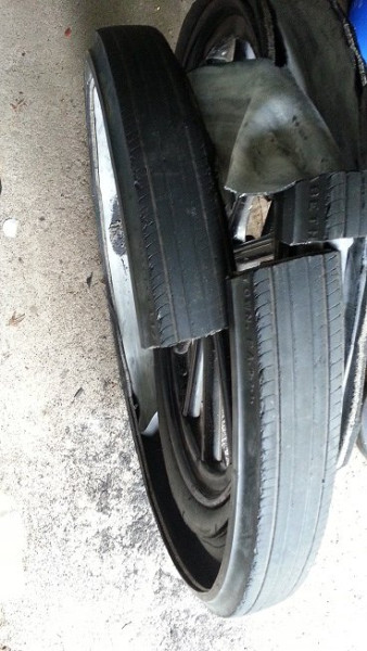

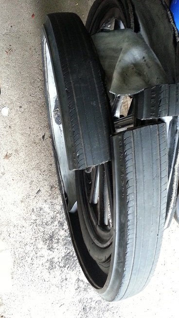

The one I just cut off just developed a leak at the base of the stem, so it had to be changed and the right front one in the photo, is bald. That is only 2 good ones left and I don’t think it would drive very well with 2 brand new tires and two questionable 51 year old tires. Since I will be selling the car, I think 4 brand new tires will be a good selling point, plus it will be safer. Can 21” steel wire beaded tires be mounted on split rims that remain locked in place? Jim Patrick

Tools needed to remove old rock hard tires are theses:
A good reciprocating saw with all purpose metal cutting blades.
Some tire irons to pry with and a good pair of fairly large bolt cutters to be able to cut the beads.
Once you cut through the first bead then you can begin to pry off the tire.
You can bend or ruin a rim by heavily prying on old hard tires. You have to be careful.

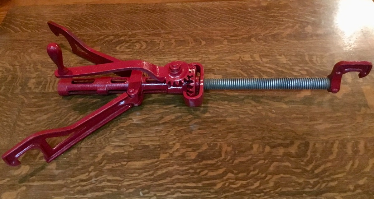

The picture you are showing indicates you have split rims. Would you have been able to collapse them with the split rim spreader? Were the stuck to the rim all the way around? I have been able to collapse tires of all three types of rims by jacking up a heavy vehicle such as my pickup and putting the jack over the tire next to the rim and lowering the vehicle. This pushes the tire away from the rim. If that doesn't work, try the edge of a tire iron or a chisel between the rim and the tire to get it started. Usually works.
The hardest tires to remove are usually the clincher tires when they get hard from age.

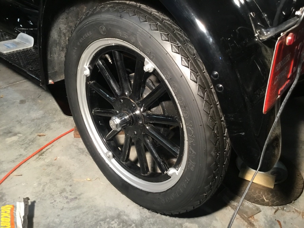

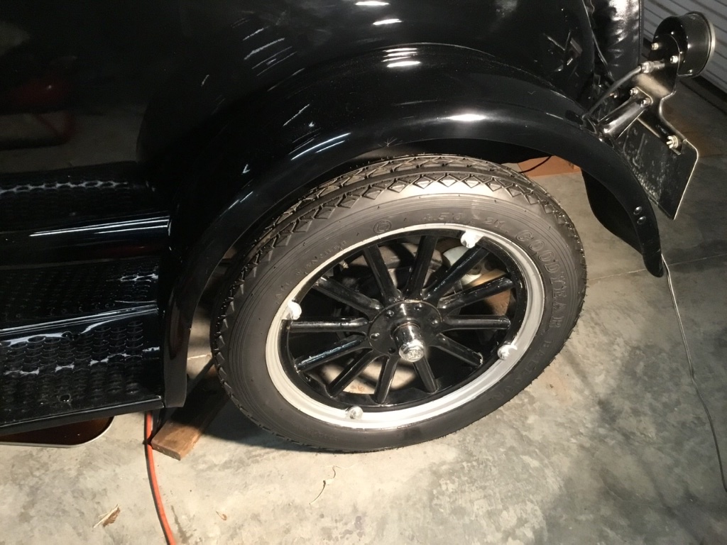

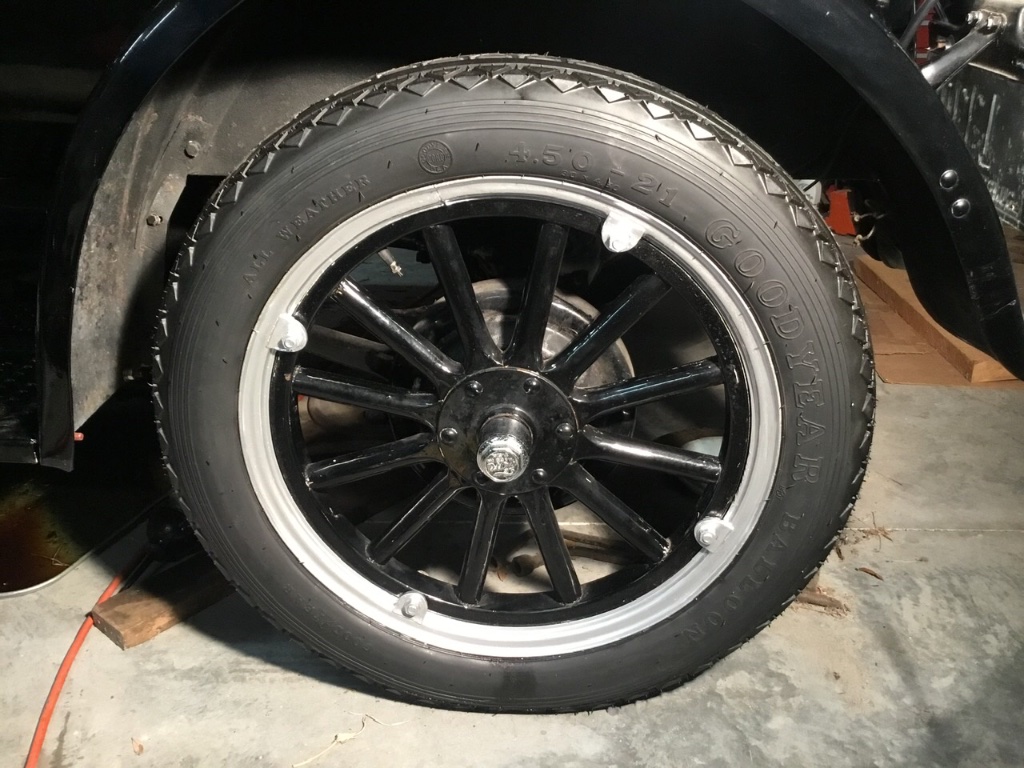

With the help of my Hercules rim spreader, I got all the new 21” Goodyear tires, tubes and flaps mounted on the split rims. By the last one, it got so much easier than the first one. Before mounting each one, I repaired any broken rim locks and removed all rust with muriatic Acid and neutralized with baking soda, then painted the rims silver with very durable “Sherwin Williams Silver “ metal roof paint. They couldn’t have turned out better and it is a relief to get this job done. Now I can concentrate on getting the engine in good running order and am very anxious to take it out for a drive once I get ‘r running. Thanks everyone for your help. As usual, your advice was very helpful. Jim Patrick

Nice job on those tires there Jim... With the smooth ride those new tires will provide you may end up not selling!!
