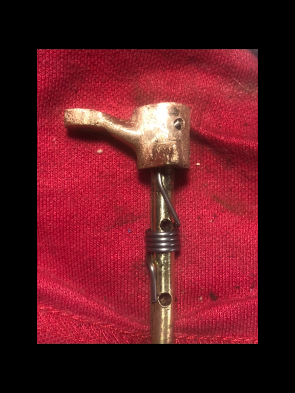

(Sorry Tom I kind of stepped in your thread)
Hi Scott,
I'm concerned that the shaft length of the NH are to short for the brass throttle & choke arms that are pinned to the shaft. I can reem the carb for a larger size but can't make the shaft longer.
Thanks.
Craig.
Hi Scott,
Thanks.
Craig.

That's OK Scott,
I didn't realize there was that much difference in the shaft length until I took a shaft out of an other carb to do just that
with. Out of three drawers of barbs I didn't find a single shaft long enough. Or one that I would consider breaking up a odd carb that I plan on rebuilding someday. Now I'm trying to figure out how to cut the slot in the shaft. When it comes to machine work that maybe above my pay grade or patience level. The carb on the firetruck works fine so this is about #136 on the todo list. Using later shafts with steel levers my very well be the only solution.
Thanks.
Craig.

Well, you made me look...
I just pulled out an L-4 carcass and found that an NH throttle shaft is about .050" too long (and could be made to work by shortening and drilling the throttle plate for the slightly offset holes for the staple). The choke shaft is a good deal too long and could be centered when the casting holes are bushed down to match the 3/16 shaft...the choke plate staples can be centered just fine without redrilling. Nothing is too short, so am confused by your findings.
OK...Now I finally see that your levers are brass and are pinned on...so you are working with an L or L-2 and I somehow got on the L-4 bandwagon...sorry about that. I don't even have to measure an older KIngston...I'm sure you're correct. They likely need custom shafts, but unfortunately the carbs aren't worth enough to warrant the cost of machining one. The MTFCA Carburetor book shows someone building up a worn shaft with a brass tube...an OK repair I suppose, if you're careful.

Sorry Scott,
I didn't specify model # because I didn't think they made a brass L-4 the label is worn off so I can't tell if it is a L or L-2 I don't even think the bowl is correct it appears to be machined out of a solid piece of brass. I may end up just polishing the bowl and putting it on the presant carb for show. Thanks.
Craig.

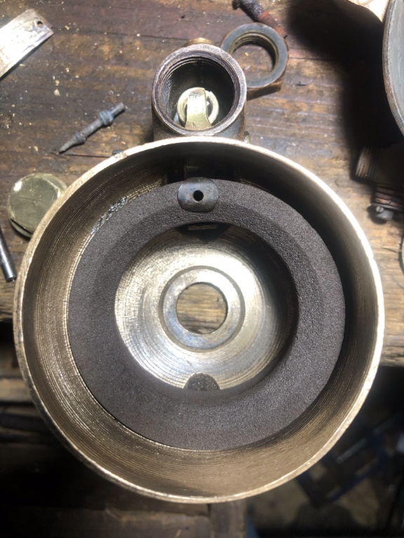

The encyclopedia discusses when the various Kingston models were introduced.
https://www.mtfca.com/encyclo/C-D.htm#Carb1
The L4 were initially made with a bronze body. I recently bought one from the classifieds. It has a steel bowl. I restored the cast bodied one recently. The brass one is on my to-do list. (After a Holly straight through I just started dismantling).
viewtopic.php?f=5&t=26641&p=205144&hili ... on#p205144
Corey Walker Recently sold a brass Kingston L carb. Very nice. viewtopic.php?f=5&t=26663&p=206733&hili ... on#p206733
There’s an L2 that sold last year shown in this post.
viewtopic.php?f=5&t=25687&p=200021&hili ... L2#p200021

The one with the machined brass bowl is the first model L, the L2 had a steel bowl and a more conventional float arrangement. The L had the choke shaft with the hidden spring, the end pokes through a hole in the body instead of wrapping around a post cast into the body.
