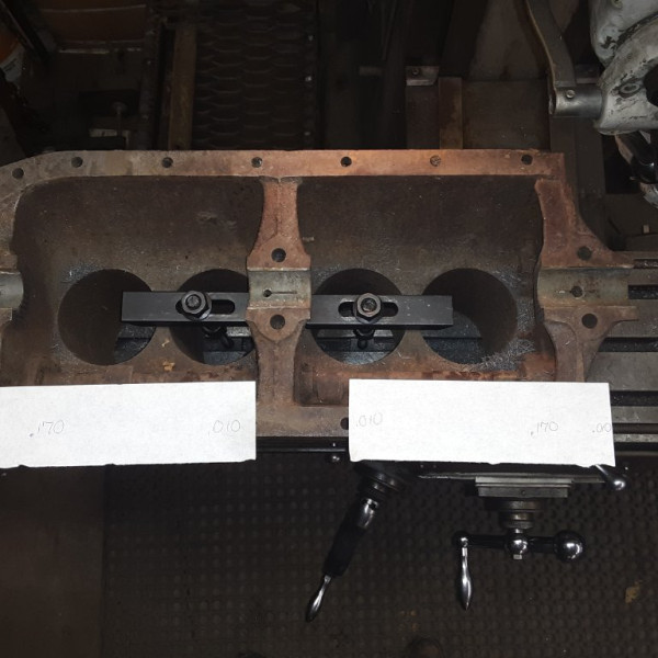

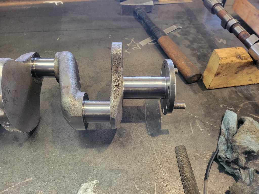

Practicing on junk block, and looking for constructive criticism. Do these numbers make sense to those of you that have done this.This is the amount I removed from the side of each main saddle.

I can’t see your numbers in the pic, but when I do these I bore the block out to the edge of the main bolt holes for babbit bearings. For insert bearings you have to use the housing bore dimension required by the bearings used.

Erik is speaking to the next step in the process... boring out the bearing bores
Your numbers seem ok to me. I don’t recall the center main bearing moving, but the inner halves of the front and rear do get cut. Pay attention to the timing gear position, and all else should fall into place

As stated above.., you are on it!

I made the .010 cut on center main thinking it would give you some fudge up room when the thrust is cut on rear cap.

On the block, no need to narrow the center main saddle.

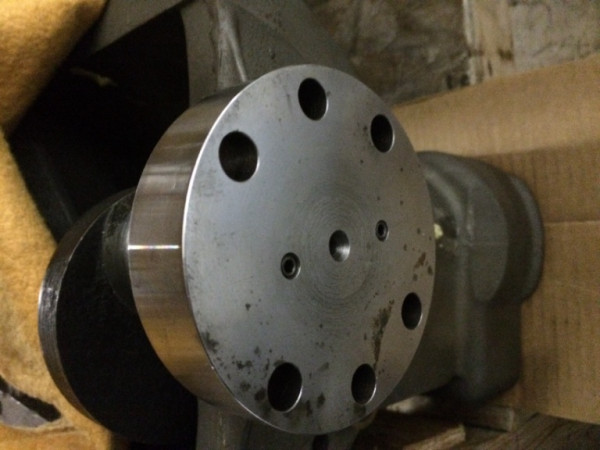

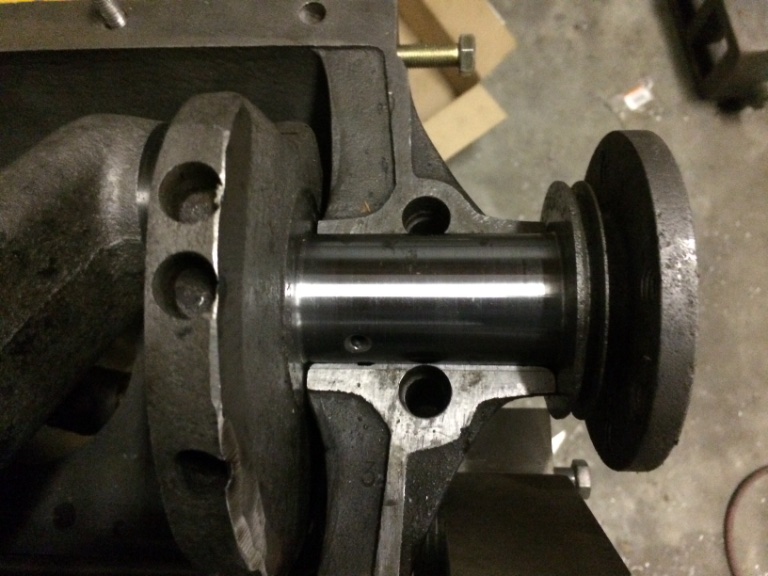

My “No Welding” method. This has been successfully used. The new flywheel hub is made of 4140

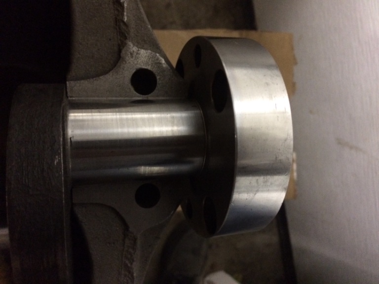

A shot of the front end modification. I have installed a “Speedi Sleeve” for the seal/packing to run on

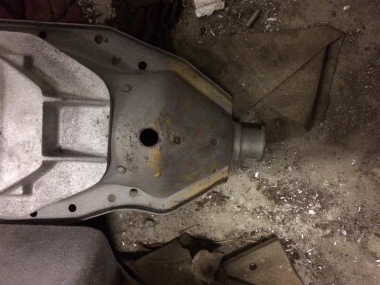

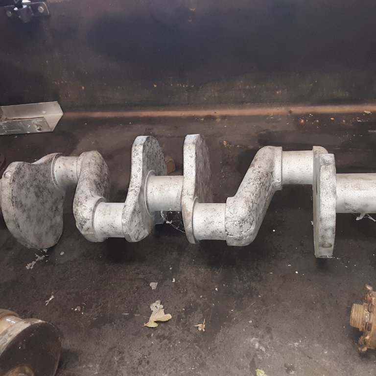

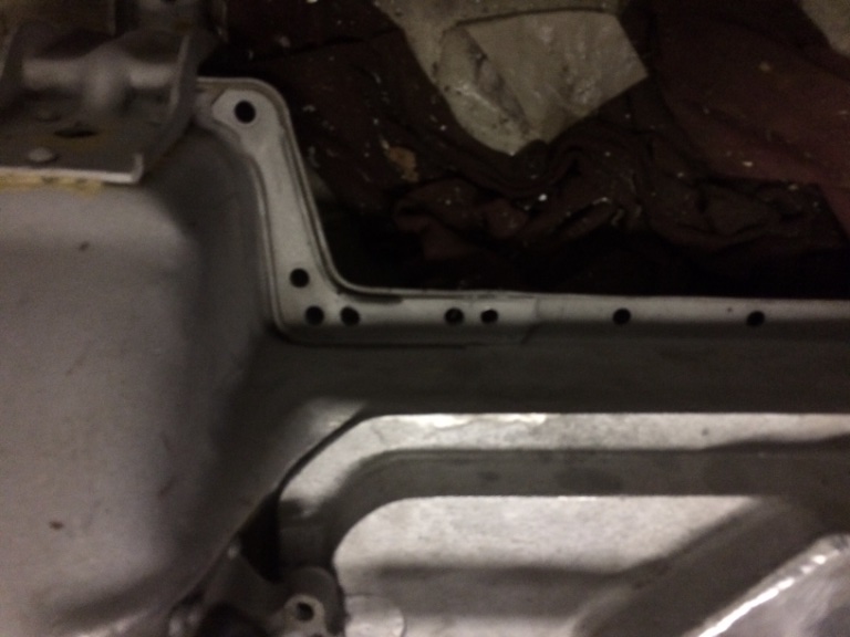

“C crank (no Speedi Sleeve yet)
Un modified back end
Shortened pan front end
STRETCHED pan!

Les Schubert wrote:
Fri Oct 29, 2021 6:04 pm
I see 2 set screws. There must be more magic involved. More than a press fit?

John
It is a tapered shrink press fit. The set screws are just for a added safety factor.
The hub is heated to 500 F and pressed on. When cool it is machined all over

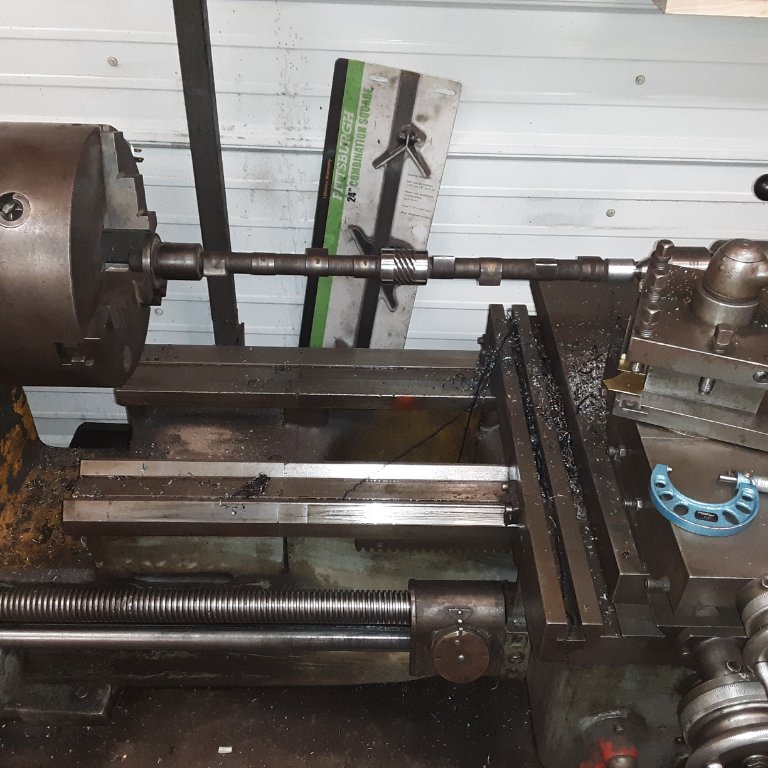

Today I thought I would take a old A cam and machine the journals to size. Was I ever surprised to find that the journals are case hardened, machineable but slow. I think when it comes to a finished product I will machine to .010 and have a crankshaft grinder finish to size.

Consider installing the cam using the same “philosophy” as in the A (running directly on the casting without removable bearings). You will have to do some “creative work” to install the gear and run the ignition anyway, so “managing” the end float won’t be that difficult!

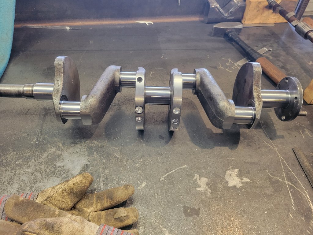

To use a B crank in a model T engine you have to turn both the rod and main journals down to model A size, so you may just as well get a counterbalanced A or Scat crank. You can use B rods in a model T if you have an overhead cam engine with no cam in the block.

Post by David Greenlees » Mon Mar 14, 2022 1:41 pm

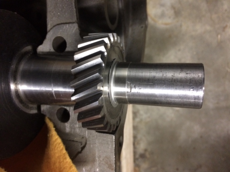

This is a forged 1933 to '40 Model C Ford factory-designed and manufactured one piece counterbalanced crankshaft (NOT welded counterbalances.) I shortened it to fit a Model T and drilled for full-pressure oiling and T camshaft clearance. All oiling holes drilled on an angle in one shot (not for the faint of heart) except for the rear rod journal that is crossed drilled (to get the oil feed hole in the center of the rear main.)
The OD of the crankshaft machined for camshaft clearance.
It was magnafluxed before and X-rayed after the conversion. The flange welding one side at a time (shortened rear main) was done by expert certified welders at Mercury Welding using the correct welding rod for the alloy Ford used to forge it from and used the right preheat and cool down procedures. https://mercurycorp.com/home-3/capabilities/welding/ when they were in the nuclear power plant welding business and had a shop near a nuclear power plant here in VT. They welded several of them for me and none of them ever cracked or broke after being driven 1000's of miles.

Post by got10carz » Mon Mar 14, 2022 7:07 pm
Looks like mine.

Post by David Greenlees » Wed Mar 16, 2022 7:27 pm
Looks like mine.
got10carz: Your crankshaft looks really nice, did you modify it yourself or did a shop do it for you? Is the rear main shortened or was the block moved forward? How did it work out for you in the end? Did you install the B camshaft on the right side of the photos as well?

Post by got10carz » Sun Mar 20, 2022 6:24 pm
Back from Chickasha, thought I should answer Davids question. I shortened the crank myself, ground to A size. I do plan to use the B cam. I have 2 different blocks going together, 1 flathead, 1 for a overhead.
