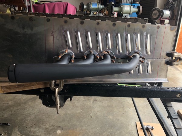

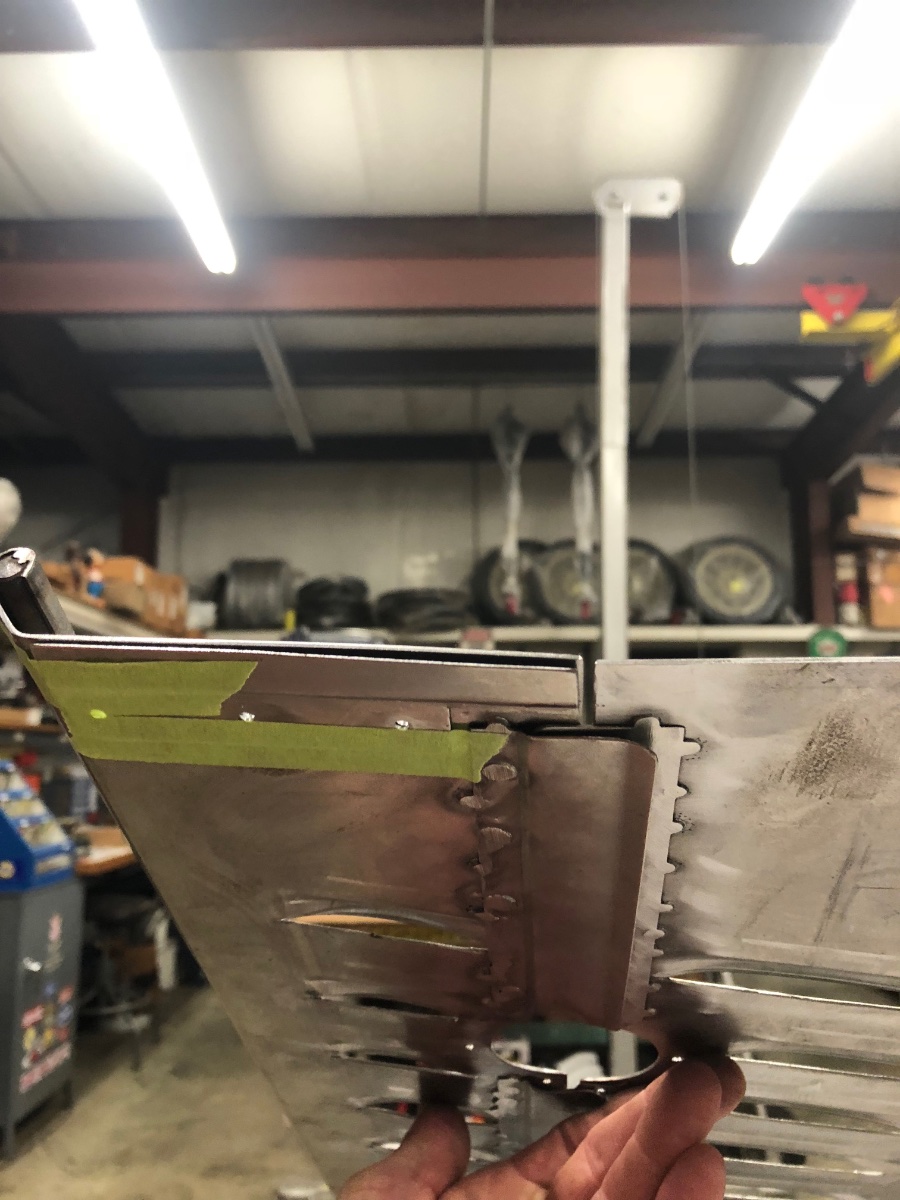

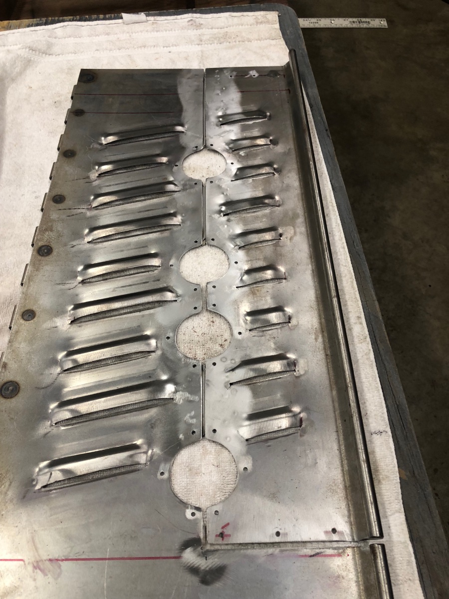

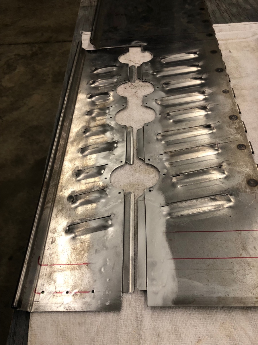

Split hoods for side deflecting headers can be a pain and causes other issues as fatigue etc.
Simple cure, "Blade and Scabbier" since the bottom is fixed and the hood will be held by 3 leather straps. Represented by the red lines.
