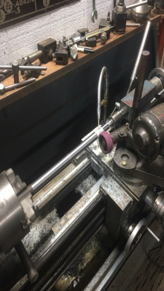

I once did one myself, with a bench grinder and hand tools! I used an era crankshaft cutting tool to cut the forward end to fit the torque tube's front bushing, then using a bench grinder with home-made go-no-go gauges carefully shaped the square to a perfect fit for the U-joint.
It CAN be done!

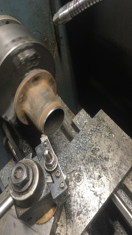

All of those things have to be shortened. The tubes I cut and machine the ends square, then weld. On the shafts I cut the front end off and machine the bushing surface and u joint square back on in the right spot.

I would add that I assemble the D/S & tube before welding the tube back together. When cooled its a quick check for any possible misalignment by feeling for any binding.Erik Barrett wrote: ↑Tue Apr 12, 2022 2:00 amAll of those things have to be shortened. The tubes I cut and machine the ends square, then weld. On the shafts I cut the front end off and machine the bushing surface and u joint square back on in the right spot.
