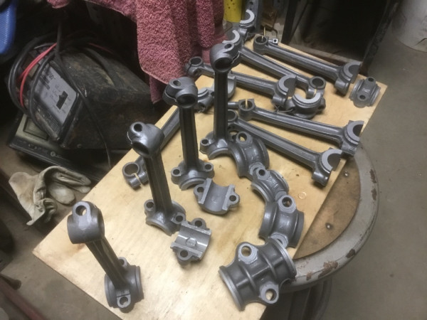

Need the center to center dimension to bore my connecting rods.
John

7 inches/CtoC

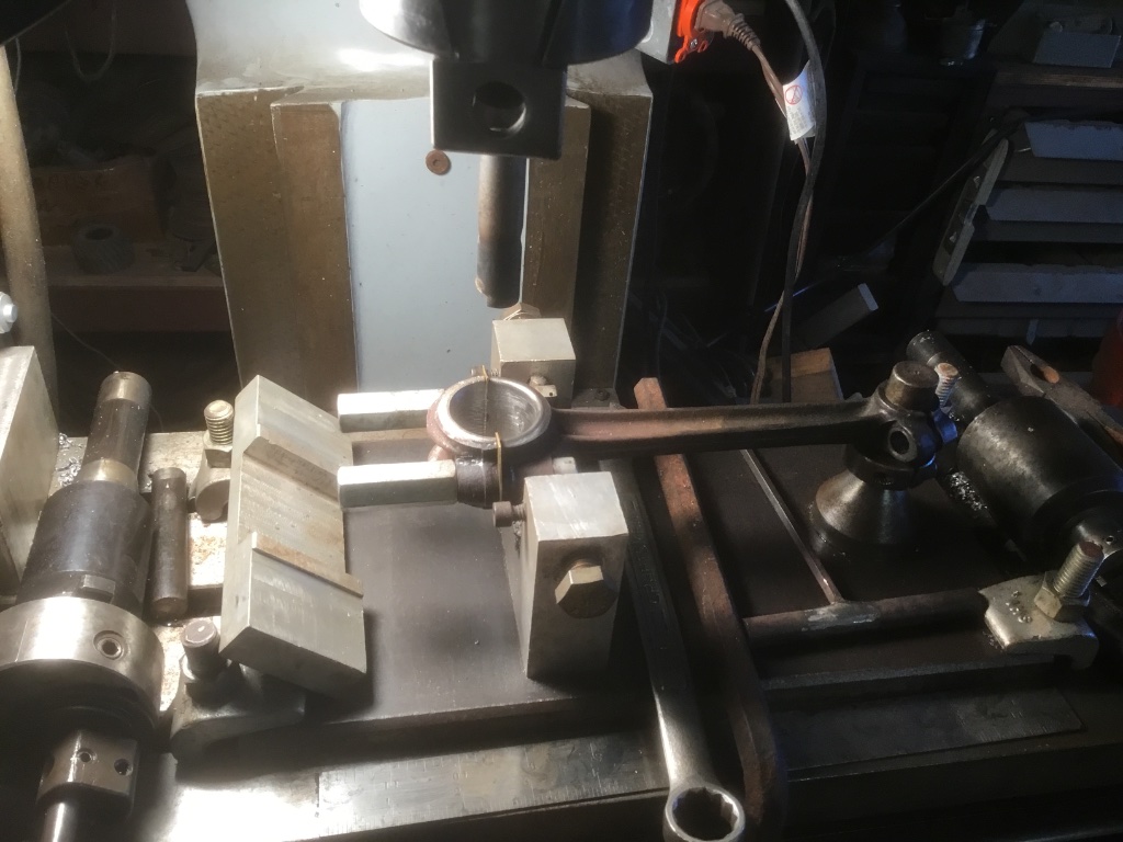

. What are you using to cut your babbitt?

thank you for the dimension.
will be boring on a bridgeport mill with a
criterion boring bar.
