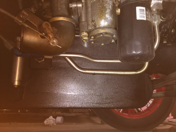

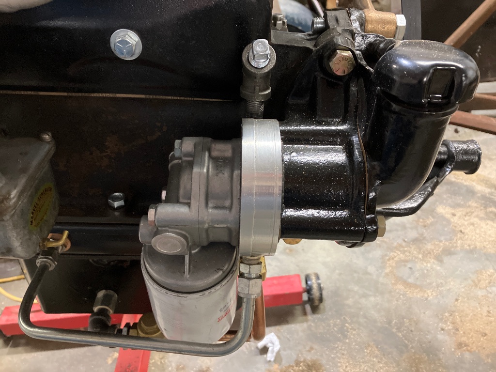

The Datsun pump has proven reliable for me...
Les Schubert
Posts: 1364
First Name: Les
Last Name: Schubert
Location: Calgary
Re: Pressurized Oil System Component Choices/Options
Post by Les Schubert » Thu Apr 14, 2022 11:46 am
The plug at the top is for priming
Datsun B210 pump
