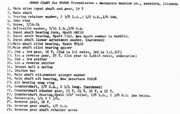

Does anyone have the replacement bearing numbers for the input/output shafts bearings if there is such thing?
Re: Jumbo Giant in/output shaft bearings
This parts list appeared in a previous post. It lists some Hyatt and New Departure numbers.
http://www.mtfca.com/discus/messages/50 ... 1420996116
Thanks to Roger Karlsson, southern Sweden.

Thanks for the information and link. I will post some photos and information on these two pigs I am now working on at a later date.
