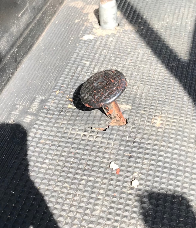

Here’s a pic

Brian, I use a wire similar to the choke cable and it comes right up at seat level. That way the wifey or I can both tug on it. I’ve got it hooked up so it doesn’t effect the use of the foot pedal. Just my idea.
Sadly , they grow into reaching the floor pedal way too soon. Let them blow away! They will never forget it.

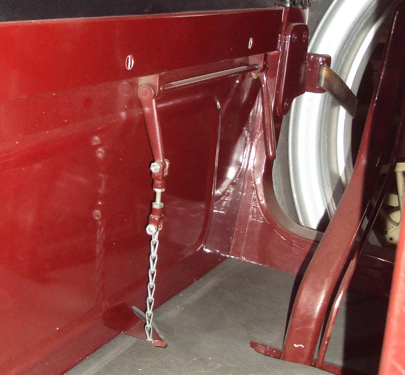

This is how I blow the whistle on my Yellowstone Bus. I need my foot on the throttle to rev the engine while I open the cutout with my hand. It might give you some ideas.

I normally connect to the whistle with a small diameter braided stainless steel cable.
That way I don't have to cut my floor boards for the cut-out pedal.
I simply bring the cable up through a crack or small hole and make a top loop in the cable.
It is easy to reach just in front of the seat riser. Works for driver or passenger.......
