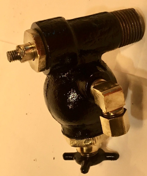

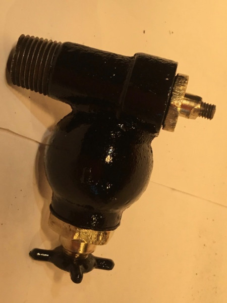

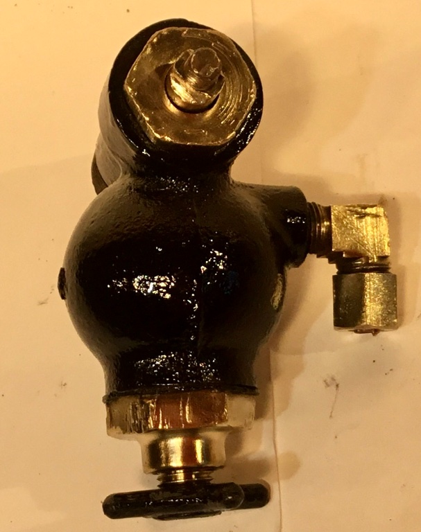

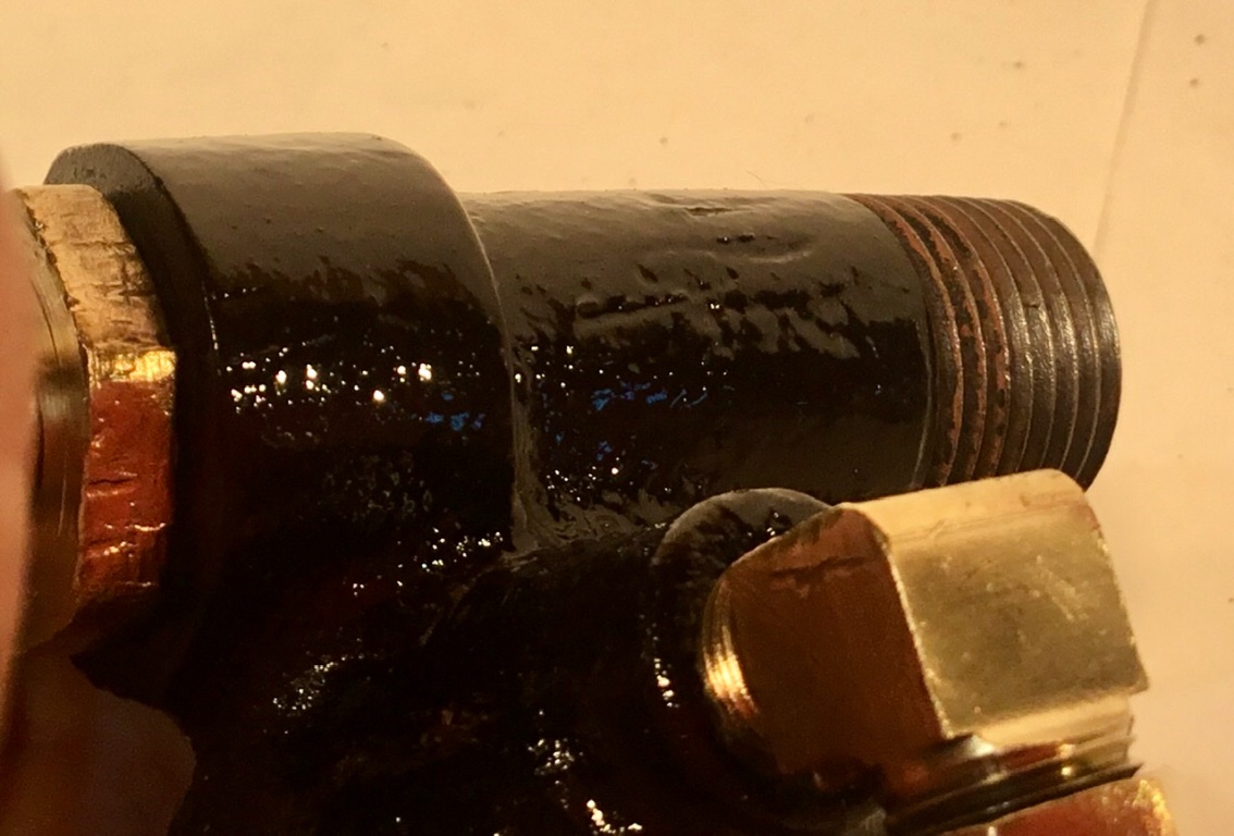

Re: Gas Line Shut Off Valve
This is the type of gasoline filter/shutoff valve you should have on your Coupe. This one is missing the shutoff handle. You can see the handle in Dan Treace’s above photo. Jim Patrick
