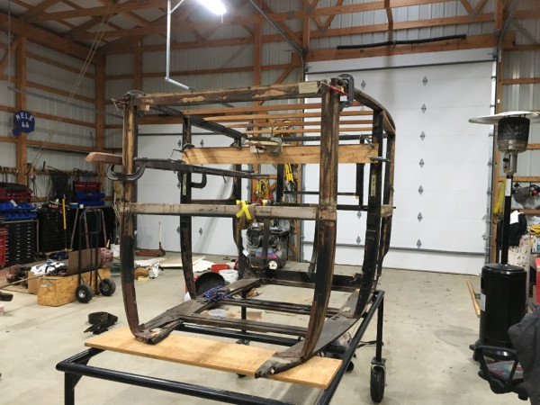

I have a 1925 to door sedan there is a number stamped on the wood frame by the drivers door does this have any significance the number is H31752

1st time owner any help would be greatly appreciated I have the wood all done quite the learning curve

This previous post discusses body numbers.
https://www.mtfca.com/discus/messages/1 ... 19926.html
Way down in the discussion I see an “H” number like yours. That post says it might identify the manufacturer as Hayes.
