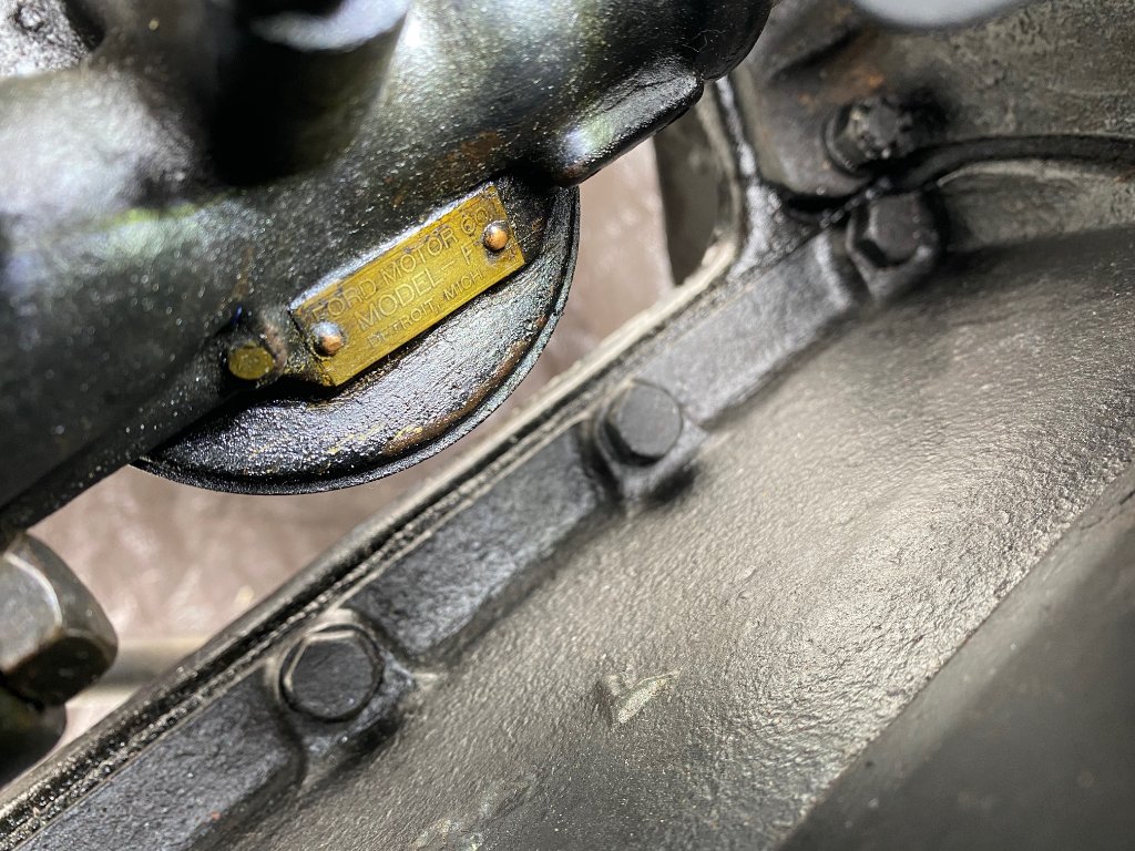

The carb shown below looks to me like a Holley NH but it has an interesting nameplate on it where it is identified as a Ford Model F. Can you tell me anything about it?

That Ford F is an HN Holley design, that Ford made under license from Holley, during the twenties for a time Holley could not keep up production, so Ford made these. Same parts as the NH.

Uncommon, but not super rare. Made by Ford under license when Holley could not keep up with production. I'd think it would command a little premium to folks who just like odd-ball or unusual things.
