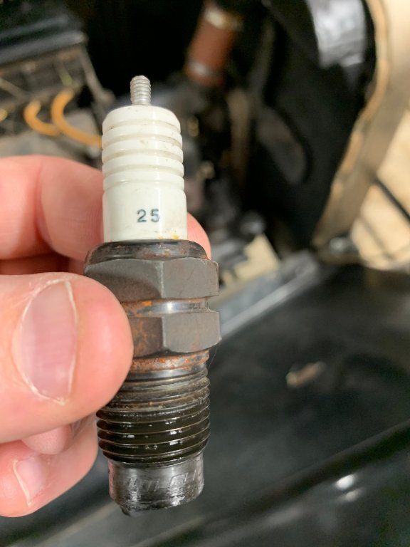

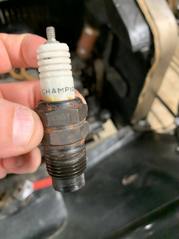

Fouled Plugs
The plugs are fouled on my ‘26. It hasn’t run right since I got it at the end of March. I’m trying to clean these as best as I can. When I look in the spark plug hole I don’t see much shiny metal at all. I assume I have some pretty decent carbon build up. What causes this? I’m no stranger to old cars and cars in general. I realize that too rich of a fuel mixture can cause it. Also not getting the engine up to operating temperature, but what else? How far do I have to drive it to warm it up?

I was getting some black smoke last night. I suspect that this car was restored in the 70's. The previous owner probably bought it from that guy (in 2011) and it was probably not driven much before he bought it. He said, and you can tell, that he cleaned the gas tank out. I never use ethanol in my A, T, '55 Chevy or mower. Maybe one night this week I'll take it on a long drive (if I can stand the jerking, bucking, missing) and see if that helps.TXGOAT2 wrote: ↑Tue May 10, 2022 8:55 amIf you have a water pump and a good radiator, I doubt if your engine got even halfway warm on a two mile drive. Your car probably needs the ignition system wiring and timer checked out. The coils most likely need to be checked out and adjusted properly. You may have carburetor issues. A few 2 mile commutes, even in a brand new Model T with a water pump would probably foul the plugs. That's very harsh conditions for any motor vehicle to operate under on any regular basis. A Model T in fair to good condition will start easily, run on all four cylinders, and easily reach speeds of 35 MPH or more in high gear. The engine should not emit significant amounts of smoke. Blue smoke indicates oil burning. Black smoke indicate a very rich fuel mixture. Fresh, clean gasoline is a must for any car to run properly. The federal crap sold today under the name "gasoline" can spoil very quickly under some conditions. Model Ts have a fuel system that is vented to the atmosphere, and that is not the best situation for ethanol-adulterated gasoline. A vented fuel system can allow ethanol-adulterated gasoline to lose quality and absorb moisture far more qucikly than a closed system will. You can use ethanol-adulterated gasoline, but use the lowest % ethanol gas you can get, and make sure it is fresh. Non-ethanol gasoline is the best choice, if you can get it. (And afford it)

When cleaning plugs, it's important to get the insulator around the center electrode on the inside of the plug as clean as practical. This can usually be done by soaking the plugs in a strong solvent, such as B-12 Chemtool, overnight in a covered container. Then remove the plugs and gently remove the carbon between the insulator and the plug body with something like a toothpick or a sliver of hardwood. You won't get the insulator clean and white, but get as much carbon off of it as you can. Filing the electrodes on an old, worn plug can improve its performance, if done correctly. It can be difficult to reach down into the narrow gap between the center electrode insulator and the plug body, but that's what really needs to be cleaned. A clear, close-up picture of the cylinder end of your plugs might give some idea of their condition.
