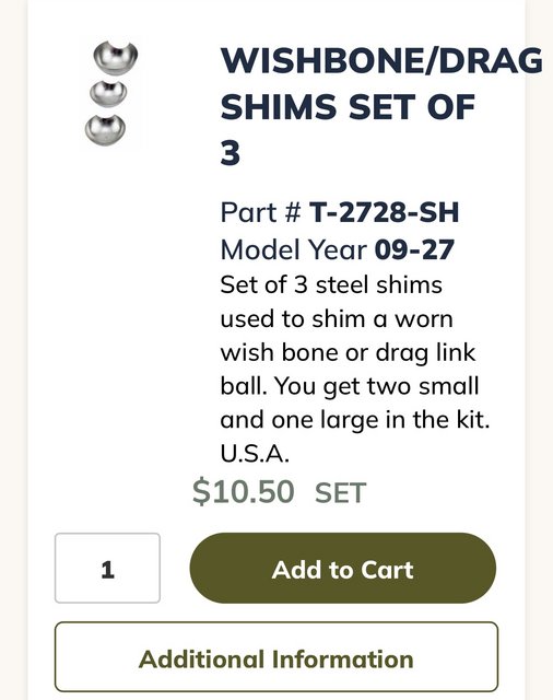

I had the same problem on my ‘22 Coupe until I found the front end steering loose just a tiny bit. I snuggled up all the bolts and still found the drag link balls loose when grabbing the area and shaking. Added shims to the sockets and all is well now.

Dont do this. This is a temporary 1/2 8$$ fix. You need to go thru every thing. Replace/replace balls & sockets.MichaelPawelek wrote: ↑Sat Jun 18, 2022 8:31 pmI had the same problem on my ‘22 Coupe until I found the front end steering loose just a tiny bit. I snuggled up all the bolts and still found the drag link balls loose when grabbing the area and shaking. Added shims to the sockets and all is well now.
Dont forget the steering frame bracket bushing.
Few T's get the full correct front end restoration. When they do, they are a tight pleasure to drive.
