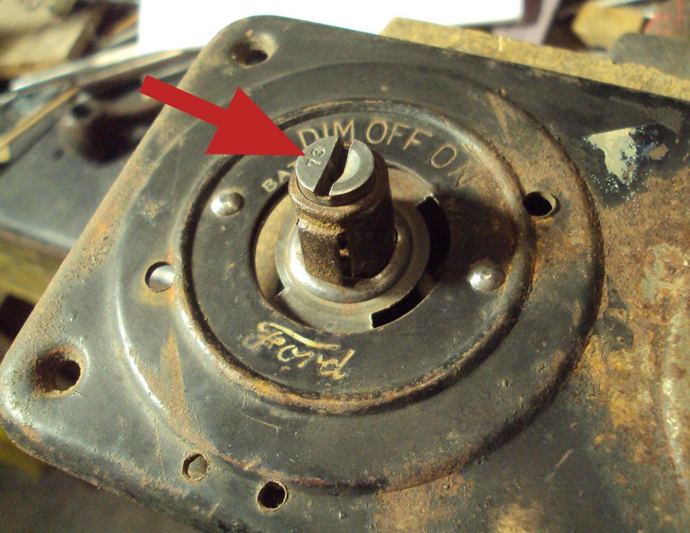

I am headed down to California to pick up my new 22 pickup and there is a chance that the key is missing. I see that I can get replacement keys, but I don’t know how to do that if I don’t know the number. Is it stamped on the switch somewhere?

The key number should be on the cylinder head, but it may be hard to read. You could also get a set of dealer keys. There are 4 of them and one of them will work on your pickup.

The odds are quite high that the key cylinder is broken anyway.
The pot metal cylinder absorbs water and expands with age.
The top and bottom of the key slot is usually broken or missing, as it appears to be in the above photo.
