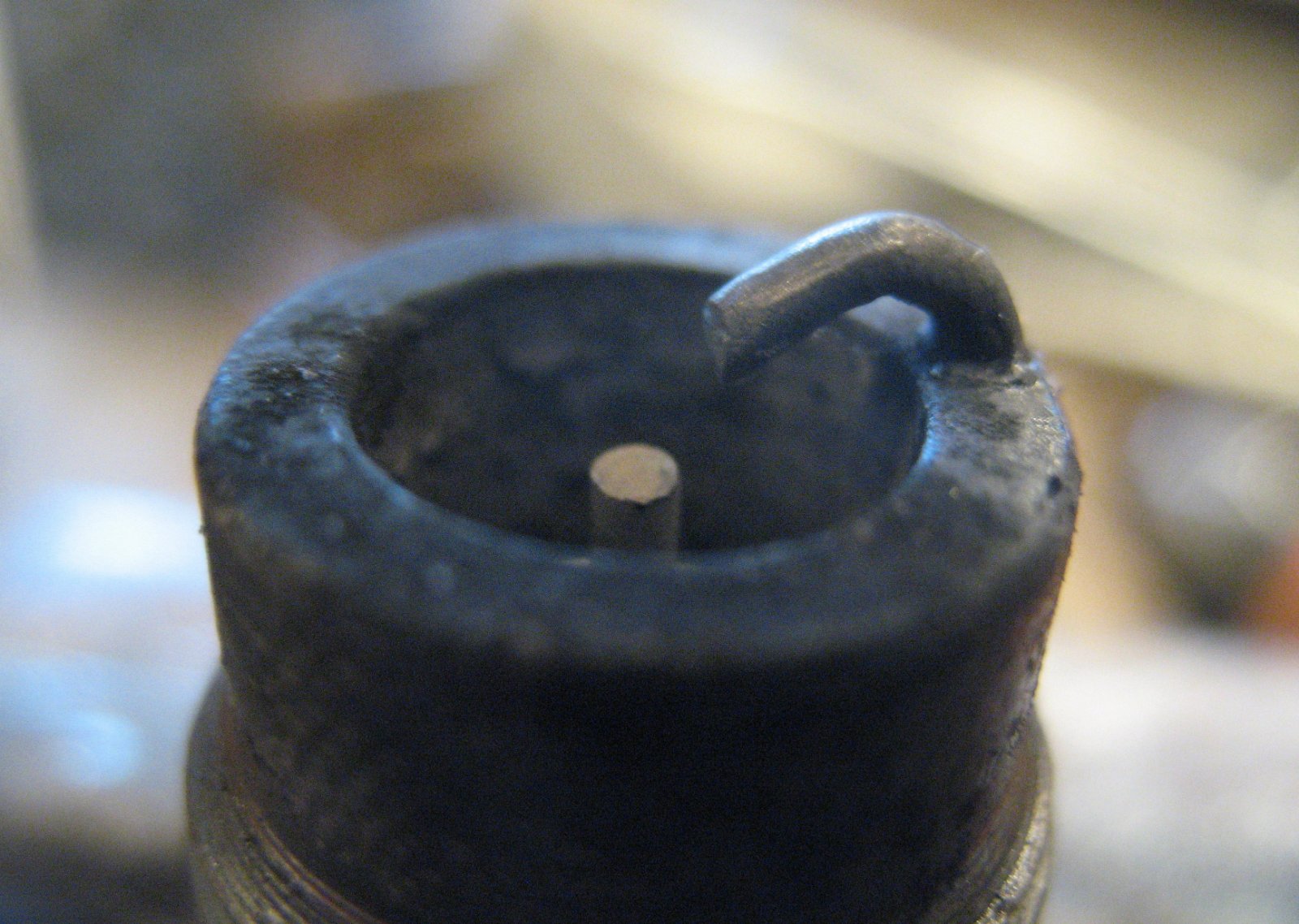

Yesterday I started my 1923 touring for the first time in over a year. The tank was bone dry, so I put in three gallons from the running board cans that were filled last September. Work I'm doing on my mowing tractor required me to drain its tank, so that's another couple of gallons for the T. That tractor has been out of service for over a year, so the gas is at least that old. When I tried to start the car it was no-go. Lots of turning over brought an occasional cough, but no start. "Well," thought I, "All those warnings about ethanol gas going bad must have been right."
But on a hunch I took out the spark plugs and replaced them with a set of "new" 90-year-old X plugs. You can guess where this is going. On the first try the car fired right up and ran normally. I drove it into town for groceries and it continued to run normally. I stopped at a filling station and topped off the tank with a few gallons of fresh gas, which didn't seem to make any difference in how the car ran. So my previous experience of having no trouble with E-10 in a Model T continues. I realize that gasoline blends vary by region and by season, so I can't say my experience wouldn't be different in another place or time, but so far I have no horror stories to report. Mister Thrifty does not love the prospect of spending an extra 20¢ to 30¢ (or more) a gallon, and E-10 is usually the least costly grade, so that's the fuel of choice unless experience dictates otherwise.

I'd be curious to see what a forensic examination of the old plugs discovers.

I’d like to see this as well.RustyFords wrote: ↑Mon Apr 08, 2019 12:39 pmI'd be curious to see what a forensic examination of the old plugs discovers.

As requested, this morning I got out the plug tester and checked the plugs I replaced. The first one was OK. When I applied pressure to the second one, air blew out of it due to a loose collar. So that cylinder lacked compression. After I tightened the collar the plug tested normal. The other two plugs simply don't fire at all. I don't know what's wrong with one of the dead plugs, but the photo shows the other. The mystery to me is how I ever installed that plug in the first place. Anyway, fire on just one cylinder explains the non-starting.

My eye tells me the gap is about 0.080"...
That's fine if you're running a GM HEI ignition system !
