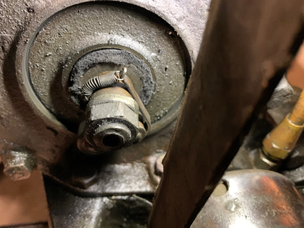

I did a little exploring this morning on my ‘26. I think, based on what I hear on here, that this is bad. True? Replace the roller, too? Could this be causing the misfire?
I’ll probably just go back to stock at this time.

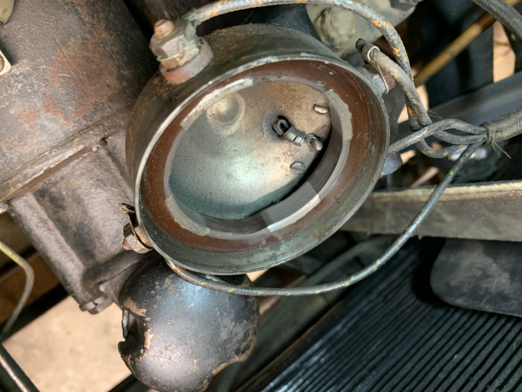

It won’t let me post another picture, but the inside of the case has big dips and ridges. It’s not a smooth perfect circle inside.

Do I have the Carbon Brush style?
Moxie26
Posts: 2067
Last Name: Jablonski
Location: New Jersey
Re: Bad Commutator?
Post by Moxie26 » Sat May 14, 2022 6:40 pm
Looks like the standard Ford style roller brush on the camshaft using the usual commutator case
Wash board road. timer skips firing @ higher RPMs.
Fit the symptoms?? Change the timer & get those coils tuned & you should be @ least 80%.

The roller timers are supposed to be cleaned out and oiled occasionally. That certainly looks dry in the picture.

I am finally able to post a picture of the interior of the timer. For some reason my phone wouldn't let me post 2 pictures this weekend.
Mark Nunn
Posts: 1289
Last Name: Nunn
Location: Bennington, NE
Re: Bad Commutator?
Post by Mark Nunn » Mon May 16, 2022 8:32 am
That looks like a Tiger Timer since the insulating material is maroon. Yours is definitely worn with dips in it. I don't know if it would be cost effective to have the roller surface turned back to round. Replacing may be your best option. I have a Tiger Timer that has a perfectly round surface and have never had a miss with it.

That timer is shot. Roller timers are excellent running timers, but they require frequent oiling and cleaning. My suggestion would be to get one of the recent reproduction new day timers and put a neoprene seal on the cam. The new day will still require occasional cleaning, but does not require oiling and cannot short out like a metal cased timer can. The timer completes the circuit for each coil by connecting the windings to ground through the roller and camshaft. You will need to reset your initial timing so that the plugs fire just past TDC with the spark lever fully up.

Also....with the kind of wear I have here is it possible that it was installed off-center and that's the problem? How do I make sure it's centered?

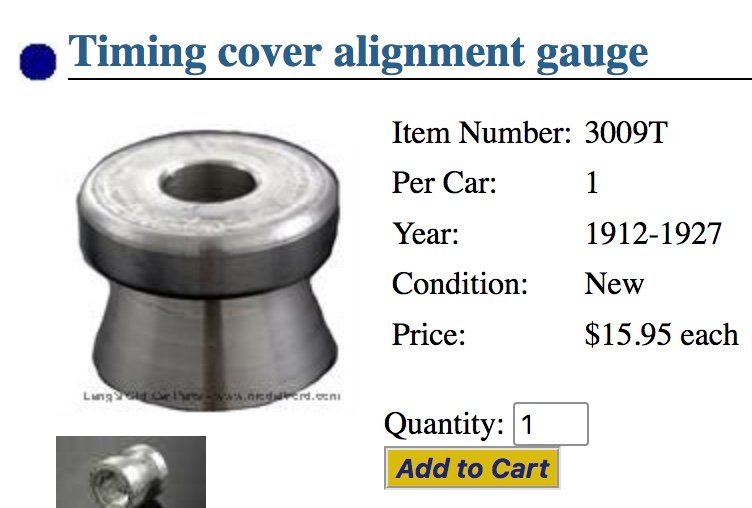

Off center? Well, it's possible the timing cover was not properly installed. There is a tool you should use any time you install the cover to make sure it is centered on the camshaft - several versions of the tool are available but I've used this one with great success. Pulling the timing cover is easy though plan on replacing the gasket. Me, I like to coat the gasket with a thin coat of Permatex ultra black sealer but I'm sure others have different ideas as to what works best.
If you buy or borrow a centering tool, you can check the alignment of the cover before you make any decision about pulling it.

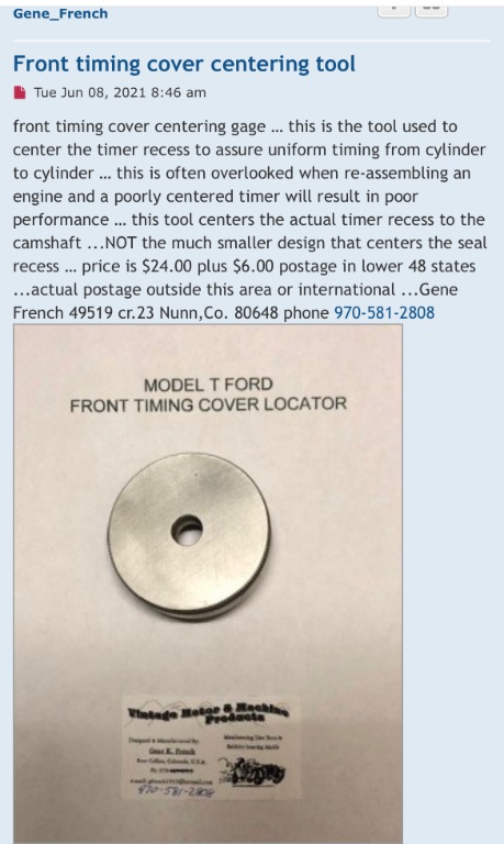

Scott, could be off center, Gene French makes and sells a timer cover alignment tool for a very reasonable price. Handy to have even if you don’t need it now. Right now though you have a ton of questions in multiple areas. At the same time you have a bunch of folks trying to help you with those issues based on their experiences. This exhibits the quality of folks here by their efforts to get you up and going with the best possible outcome. I would strongly encourage you to act on one thing at a time. Handle that issue until resolved, then move to the next issue following the same process. What could happen if you try to tackle multiple issues not knowing if the one issue is causing collateral issues. I do know at least one thing for sure, based on experience, if you don’t have a process and check list of things to do and solve one at a time, you will have a yard sale going on in your garage, get overwhelmed and walk away in frustration. The good folks here want you to succeed but you’ve got a bunch of things that you’re already working on, planning, trying to solve and you’re adding more. The commutator is one of those things that you need to take your time with. A process is needed here. Given the fact you’re thirsting for knowledge, with no help close by puts you in charge of the outcome. An example of disassembling the timer, brush, oil seal & control rod is getting it back together! That is if you remember what you did. Not knowing the engine, you may have a style camshaft with the pin hole that is straight through. You take the brush off and haven’t marked the side where the pin went in, you could be 180 out, causing your to redo work already done. Attaching wires to the new commutator requires you to get them in order and attached so they don’t ground to the plate when clamped ont the timing cover just to mention a few things that could go wrong. Scott it’s not a sprint, it’s a marathon. Take your time, establish a process and succeed. We’re rooting for you.

Do not use the "small" centering tool as shown above - you want the "large" one as John mentioned above as it actually does center the timer case to the timing cover !

Scott, could be off center, Gene French makes and sells a timer cover alignment tool for a very reasonable price. Handy to have even if you don’t need it now. Right now though you have a ton of questions in multiple areas. At the same time you have a bunch of folks trying to help you with those issues based on their experiences. This exhibits the quality of folks here by their efforts to get you up and going with the best possible outcome. I would strongly encourage you to act on one thing at a time. Handle that issue until resolved, then move to the next issue following the same process. What could happen if you try to tackle multiple issues not knowing if the one issue is causing collateral issues. I do know at least one thing for sure based on experience, if you don’t have a process and check list of things to do and solve one at a time, you will have a yard sale going on in your garage, get overwhelmed and walk away in frustration.the good folks here want you to succeed but you’ve got a bunch of things that you’re already working on planning, trying to solve.and your adding more. The commutator is one of those things that you need to take your time with.A process is needed here. Given the fact you’re thirsting for knowledge with no help close by puts you in charge of the outcome. An example of disassembling the timer, brush, oil seal& control rod is getting it back together if you did remember what you did. Not knowing the engine, you may have a style camshaft with the pin hole that is straight through. You take the brush off and haven’t marked the side where the pin went in you could be 180 out, causing your to redo work already done. Attaching wires to the new commutator requires you to get them in order and attached so they don’t ground to the plate when clamped ont the timing cover to mention a few things that could go wrong. Scott it’s not a sprint, it’s a marathon. Take your time, establish a process and succeed. We’re rooting for you.

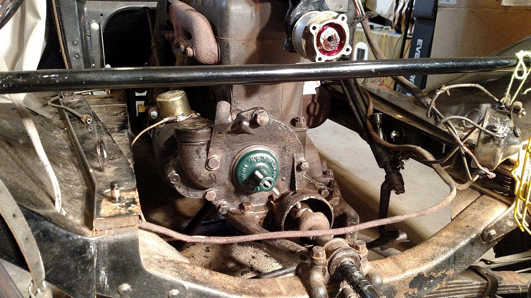

This is my reproduction timing cover alignment tool that is sold by the vendors.

I just ordered it so we'll see how I like it. Thanks! I also ordered just enough parts to put that part of the T back in good specs. That's it.....except a fan belt as mine is in two layers now.

Cat guy
Here’s a tip when installing your new timer so you can get it right.
Your timer wires look OK by the pic you posted.
DO NOT remove all the timer wires at one time.
Align your old timer with your new timer by aligning the timer rod brackets together. You sort of stack your old timer inside the new timer.
Take off ONE wire at a time and install on the same new timer terminal.
Then take off another and so and so on.
This assures you of keeping the wires on the same corosponding terminal one at a time.
It sounds to simple to get them mixed up but it can easily happen! Good luck!
By doing this you can’t go wrong installing the wires on the correct terminals.

Here's how the timer wires go. If your wire colors don't match this (some repo wiring is colored wrong), just follow the procedure John outlined.
The KRW cover alignment tool shown in Mark Nunn's picture apparently is no longer sold. It's not on Lang's website, and it's in none of the other dealers' catalogues. If you can't borrow one it looks like the only choices are the one Tim posted or nothing

Per my previous post on this thread concerning a centering tool made by Gene French. Quality work at a great price.
https://mtfca.com/phpBB3/viewtopic.php? ... 26#p218526

Actually, replacing the shot timer was one of 3 items I suggested to do based on much experience. I never said he HAD to replace it, but suggested it out of expediency and statistical probability based on the history of the car and the symptoms it presented. I doubt that many knowledgeable people on the forum would have wanted to start a tour or cross-country drive with that timer.
So far I'm 100% spot on for the first 1 of 3 items I suggested (against an absolute myriad of possibilities), so if that is willy-nilly, that must be a new phrase for "I was correct". If all 4 coils are new and flawlessly balanced to each other, and the carb is brand new, I'll be wrong on the remainder (except I've seen pix of the coils and I've seen the carb, so am not too worried about them being like new). A coil that usually fires is still a coil that is faulty as it should pretty much always fire (and be balanced either in current or TTF with the other 3), and an NH carb that has not been rebushed and rebuilt in the last 3000-4000 miles is likely worn out with a wobbly throttle shaft. I'm betting that this is the case with this car.
Time will tell, and it will take plenty of time, relative to the 2 days work my advice would have provided. If the journey is important, or the destination is important, there are two different paths to take. I was focused on the destination.

As others have pointed out, your timer appears to be dry as a bone which has resulted in premature wear to the roller and contacts ring. Timers need to be lubricated fairly often with oil or thin grease to prevent this wear.
In the 52 years I have owned my 1926 Model T coupe, I have tried virtually every type of timer on the market and have recently come back to the original roller type timer which I prefer above all others. I mixed a very thin concoction of grease using a can of 3 in One oil and Vaseline which I spread on the contact ring and roller and my T has never run better. With my mixture, I don’t believe I will need to oil as often but that remains to be seen. Either way it provides a great lubrication without affecting the electrical current passing between the contacts and roller and also prevents wear to the roller and contacts ring. One must be very careful as to which lubricants to use, for some contain ingredients that are electrically conductive, which could bridge the gaps between the contacts causing all of the contacts to fire off together and cause havoc to your electrical system. Vaseline and 3 in One oil are not conductive.
I suggest you get a new roller type timer and keep it lubricated with a simple, not conductive lubricant. I’m sure it will run much better. Jim Patrick
