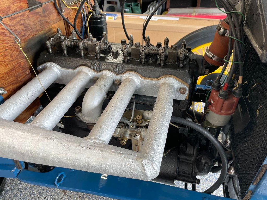

So, after a few years in storage, I've been working on getting my 1919 Speedster running.
A few items to bear in mind:
- Rajo overhead Model 30
- Hand crank only
- Texas T distributor with new Champion A-25 plugs
- Carter fuel pump with Holley regulator set at 1.5 lbs pressure; flow test was good
- Stromberg RF carb, no leaks
- half a tank of fresh non-ethanol gas
I'd set the choke, turn on the ignition, crack the throttle and pull it over. I'd get it to fire, and a few times it started but would not keep running for more than 5-8 seconds. Thinking it was a fuel problem, I checked the carb for problems and reset it to exactly where I had it when it had been running before storage. Still nothing. Three year old 6v battery was reading at 6v even, and a little lower with a load-tester, so I put it on a 1 amp charger overnight, and the next morning it started on the first pull! Ran for about 10 minutes, idled down with no problems, fuel pressure remained stable, ammeter showed a small charge, advanced the spark and she smoothed out and ran great. Next day, set everything, pulled it over and started on the 5th pull (normal when cold). Ran great, took her out and ran around the block a few times, again with no problems.
The very next day, tried starting and we're back to firing a few times, but not starting. Checked the battery again, and reading 6v. Thinking perhaps the battery needs replaced, I put in a new 6v battery, put it on the charger overnight to be sure it was up to snuff after sitting on a shelf for a few months. Tried starting it this morning and the same result; will fire, but won't start.
I'm planning to go through the electrical system to look for loose connections, bad ground, etc. Timing is good, compression is good, and the car ran great two days ago, so I'm assuming the fuel flow isn't the problem. That leaves ignition/electrical as the prime culprit. Very frustrating.
If anyone has any insights they'd like to share, I'm very appreciative of any guidance and advice.
Thanks all.

Thanks to all for your input. Here's a quick update:
- Battery voltage is good. Checked with a load-tester and only dropped from 6.4v to 6v with a load. Still need to check other wiring connections, but I have power to the fuel pump, horn, lights, ammeter, etc. Cleaned the posts and terminals anyway and reconnected.
- Inside of the distributor was clean; no oil or debris of any kind visible. Checked points and found them at 0.014", which seems a little tight, so polished them a touch and opened them up to 0.017" (Texas T installation instructions recommend 0.015" - 0.020" points gap). Also cleaned the contacts on the rotor and inside the cap, as well as the wire contacts on the coil and plugs wires.
After all that, I tried it again, and now no fire at all. Pulled plugs and laid them on the head with wires attached and got no spark at the plugs. Removed the cap and saw no spark at the points either. So now it's worse than when I started.
I have a new cap, rotor, condenser, and points coming tomorrow. I'll check connections from the battery forward to make sure everything is clean and tight, but I'm thinking it's likely the condenser; possibly a loose connection in the distributor housing itself.
More updates to follow.

Another update: I replaced the cap, rotor, condenser, and points (set at 0.015"). Coil tested good. Plenty of battery. Tested continuity on all coil and plug wires; all are good. Put it all back together and tried starting (crank only). Got it to fire and run for 2-3 seconds and quit. Got repeated fires, but didn't want to start and keep running. At least I'm back to getting her to fire!
Yes, I do have a ground wire from the dizzy housing to the block. Contacts are clean and tight. I'm at the point that I don't think it's electrical or ignition, with good readings and new parts. No other electrical symptoms to resolve; as far as I can tell, electrical and ignition systems are in good shape.
Next steps will be to recheck fuel flow from the tank to the carb. I'll also see if I can get my hands on a known good carb to eliminate that as a potential problem.

Starting & then dying sounds like a fuel issue. I’m on my phone so haven’t read all your attempts. Is the fuel in the line fresh, fuel pump pumping, carb float working
- Posts: 7411
Re: Diagnosing a Starting Problem
This may be a silly suggestion, but have you inspected the carburetor throttle shaft? If it's loose, the hole may be wallowed out and sucking more air than fuel.
