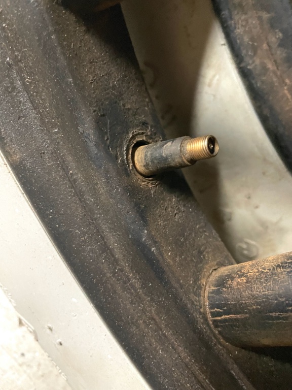

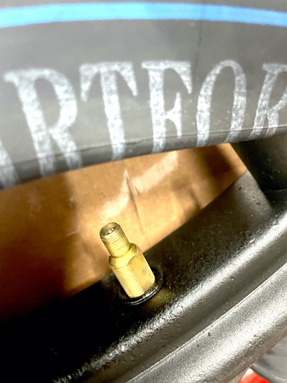

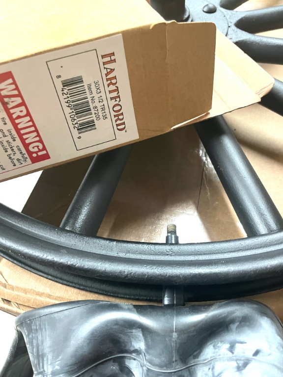

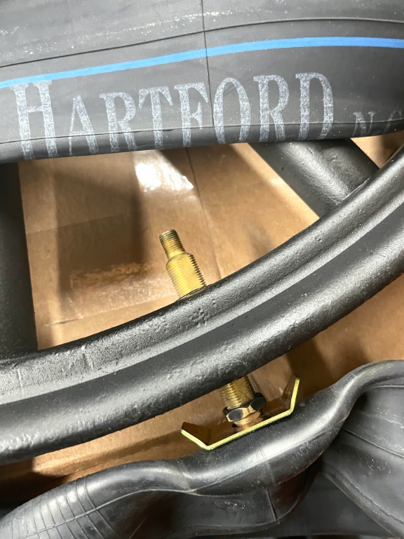

Those rubber stems won't fit into the felloe of early Ts or even the wire wheels. The rubber stem is tapered and fat at the base, can't pull it up into the clincher rim. Most everytime have to overdrill the hole for the valve stem with a step drill.
Here is a just bought new Hartford rubber stem, can't be placed in a clincher all metal felloe.
Here is a new just delivered Hartford brass stem tube, that fits great.
On this Hartford rubber stem, had to drill oversize hole, and knock out the bushing to get the tube to set fully in the tire casing and clincher rim.

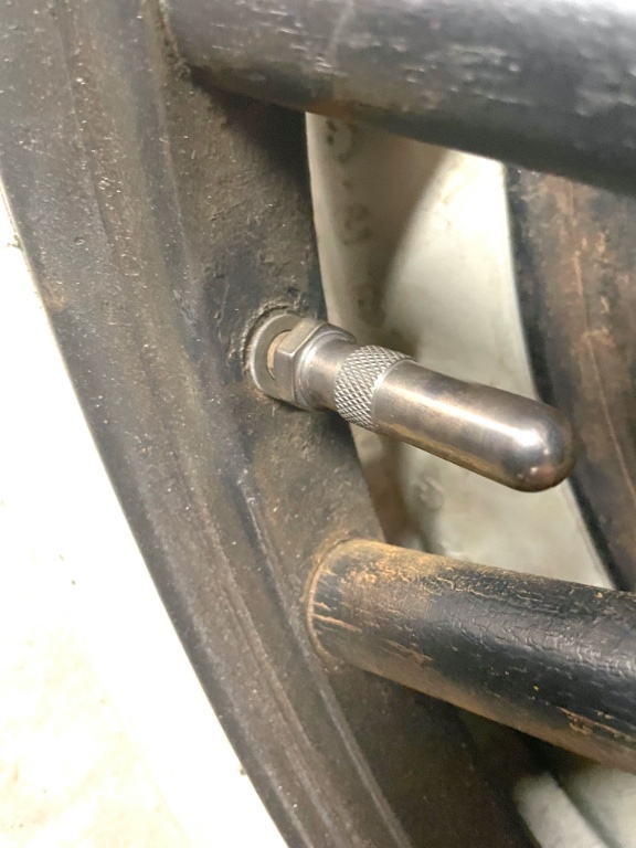

Looks ok with the accessory brass cosmetic cap for rubber stems.

Hartford Tubes like any other RUBBER stem tube availible today USE a modern stem
Stem on a taper
NO will not fit in a stock wood fellow rim
Taper reamer or drill will release the wheel
Not a hard thing to rectofy
Stem on a taper
