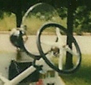

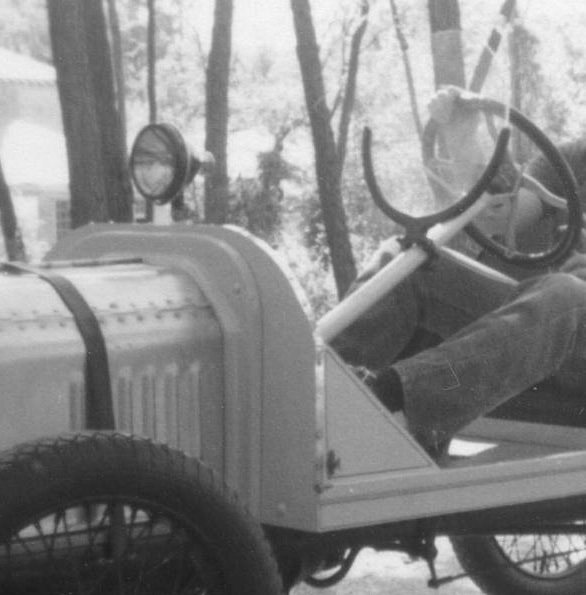

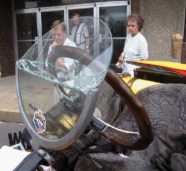

- Posts: 4113
Re: Where to get monocle windshield glass??
The late Ralph Ricks posted a pic of his speedster monocle safety plate glass busted over in line with the bracket, hit rough roads pot holes and it broke.
Glass is heavy too, once did a monocle on my 15 speedster and used plexiglass. Cut a cardboard template then cut the plexi and sanded smooth the edges and glued it in place. Windshields in cars need safety plate by state laws, but an antique car monocle to me is an exception. Anyway the plastic worked out great.

If you are using an original monocle frame/bracket this comment may not apply. If you are using a "new" frame/bracket please sight it for curvature. I helped a friend install a new laminated safety glass into the frame. All went well and the end result was perfect. The car was in storage for about a couple of weeks, conditioned storage, and when looked at to take the car out the glass had cracked. Sighting the frame carefully, we saw the real problem. The frame was not straight and the pressure on the glass caused the crack. Another piece of glass was cut but this time "tempered glass" was used. No problem after several months. Tempered glass is much stronger and can withstand the pressure apparently. The only problem is that with tempered glass if it cracks, it breaks. The result is a million pieces all over the dash/floor. Just my 2 cents.

DanTreace wrote: ↑Wed May 25, 2022 7:32 amThe late Ralph Ricks posted a pic of his speedster monocle safety plate glass busted over in line with the bracket, hit rough roads pot holes and it broke.
OUCH!
I have that same cast aluminum bracket on my speedster. I think an Elvin Townsend was selling them in the 60s. Some dealers sell a brass one that might be made from the same mold.
"Just Sayin'"

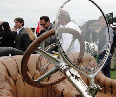

David
regarding your question regarding the use of tempered glass: Look at the laminated safety glass monocle in the picture above...compare that to having tempered glass there, which is far easier to break, with splinters of glass flying at your face and eyes in just a split-second. You won't have large slashing pieces filleting you like plate glass, it is safer than plate glass, but it is not without it's very tiny splinters at each cleavage.
So, is it still a question?
