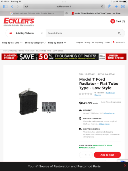

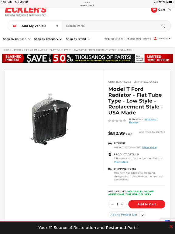

I’m looking to purchase a new low style radiator and found these two listed on Ecklers.
My question is this, has anyone purchased either and how did they work.
The customer service person was very nice but could not determine if made in America or any difference in them?
George Schmidt

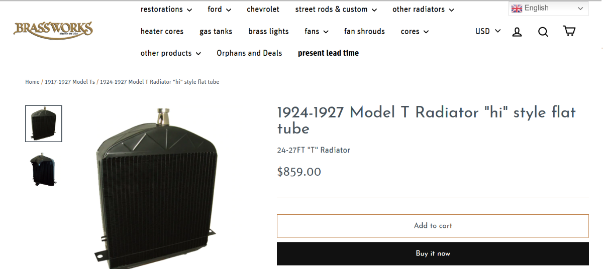

Can't say for sure but I'd guess these are made by Brassworks or possibly leftover Bergs. You should ask them. If Brassworks, you might be better off going to the source unless Ecklers has them in stock. I believe Brassworks has a backlog of a couple of months.

I'm baffled. They are both low style and flat tube. One says made in USA the other doesn't. What does "replacement style" mean?
Philip

it usually means it fits but does not look exactly like oe

The picture in Eckler's (MAC's Too) are the same as Brassworks AND that they are shipped direct from the manufacturer. Items like this are never stocked by suppliers - to many dollars sitting on the shelf waiting for a buyer.

For what I can see in the ads, the first one lists 8 fins per inch which is not a lot and the second one shows the core as off set tubes so the second one would be the better one.

The pictures of the Eckler's radiators are not of Brassworks radiators, unless they too have gone to non-original top tank outlets. Bergs had top outlets like that, but theirs were mounted differently to a one piece, pressed top tank cover. These are different.
As suggested, check stock levels first.

"Replacement Style" will invariably mean that the core does not have the steel reinforcement plate running through the core, upon which is mounted to the securing point of the T. Additionally, the top inlet and tank is not the same as the original, and in the case of Berg, the top tank is, I think, a single drawn piece of brass...not a soldered assembly...not original but pretty darn bulletproof. The Berg radiator on my father's T is of this style. It has lasted about 42 years, so I'd say it can hold up without the reinforcement so long as the frame is not sprung
Pictures I have seen of the Brassworks radiator show a pretty accurate representation of the original radiator
