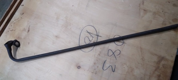

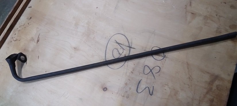

Keith, I have an original inside oil line, but don't know if it has a large funnel or not. I don't have another to compare it to. It looks to be in nice shape.

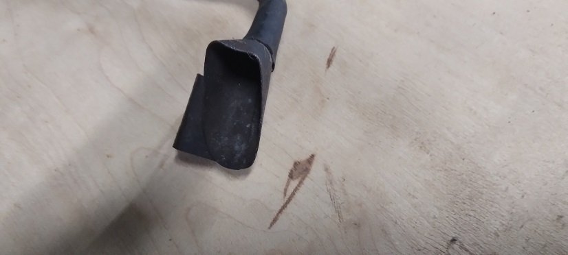

That funnel is the earlier funnel Ford used till around 1923 or maybe a little earlier.
The later funnel has a longer “scoop” to catch a little more oil. The repos that are made are really pretty good. I used one in my 21 Touring rebuild.

If a new funnel is cheap insurance, I would urge you to take out additional Insurance. Clean off the silver paint at the junction between the funnel and the tube, and make a better bronze weld attachment between the two components. Fortunately, I discovered the necessity for this before the engine was completely assembled.

Found on this site
