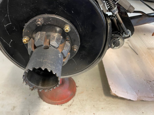

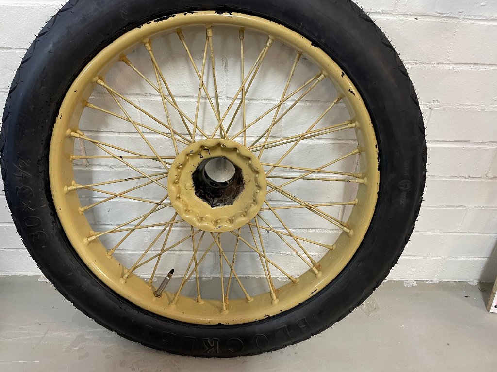

I recently purchased a T Speedster with an 8 valve Rajo head conversion and wire wheels.
Can anyone identify the brand of wheel. They are not like Hayes wheels as the rim is completely separate from the hub.
The hub shown is the RHS rear with a locking device to stop the wheel undoing on the rh thread.
Any help would be appreciated.

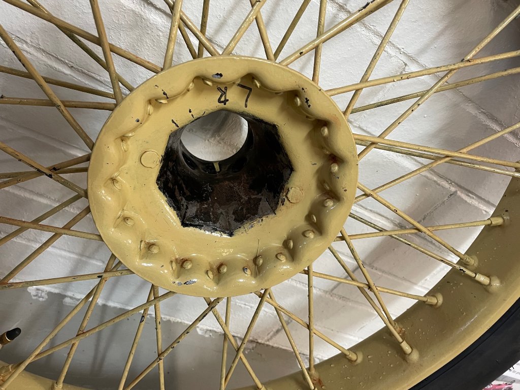

Small center Budd wire wheels. Hard to tell if hubs are made specific for Ford, most are Overland hubs adapted
