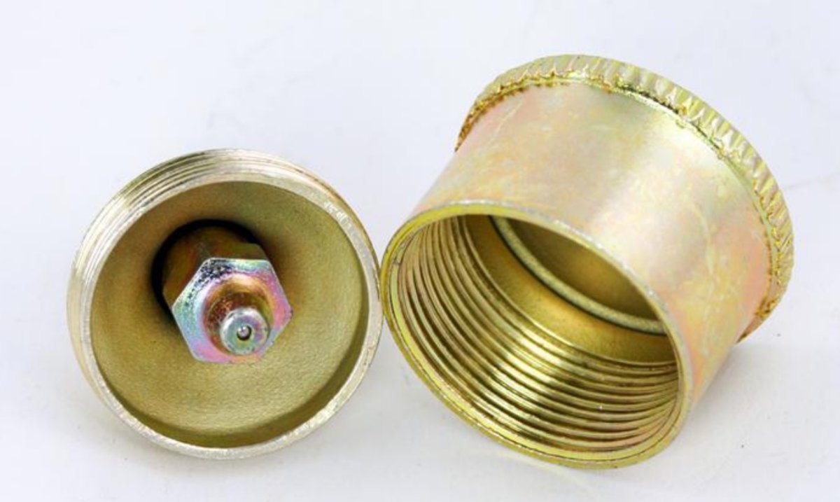

When I initially fill the u joint area with grease I unscrew the filler cup and pump the grease into the hole with a grease gun.
Someone used to make a grease cup for that area with a grease nipple hidden inside.

Michael...this is what you need. Sadly, so many U-joint "cavities" are empty like yours. You will need to pump in at least 30-35 pumps of your grease gun to get a good amount in there I'm sure. I use the good old Red-N-Tacky grease, seems to work great.
Here's what you need: https://www.modeltford.com/item/2579GR.aspx

And now that I actually read his post more carefully...looks like he's lucky that it's all apart, and yes Kevin, pack it FULL with the same Red-n-Tacky or your country's equivalent. Then get one of those aforementioned grease cups with the built in zerk.

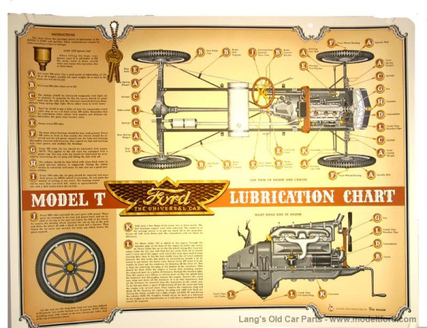

What was intended to go where - but remember its based on the lubricants of that era. The ball cap grease is for the u-joint
Lub Chart.jpg (37.78 KiB) Viewed 2597 times

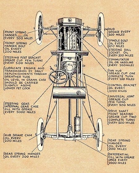

Previous posters gave you very good advice. The "ball" is one area I service (with Timken red bearing grease) prior to any tour and during regular maintenance. It doesn't seal that well and grease tends to disappear. Do yourself a favor and get the grease cup with the hidden zerk fitting (Lang's 2579GR $8.95) - The vendors also carry the smaller cups with hidden zerks and you'd be well-advised to replace them all. Photo 1
The oil in the ball may be there for the reasons previously expressed. In addition, sometimes people neglect to install the "Transmission Driving Plate shaft plug" where the differential plugs into the 4th main. Photo 2. If you ever pull the rear end take a look up there and see if the plug is in place.
