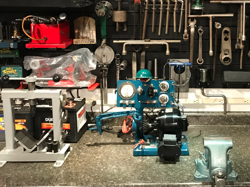

Post by Dan Hatch » Sun Jun 05, 2022 9:35 pm
Here is what I use.

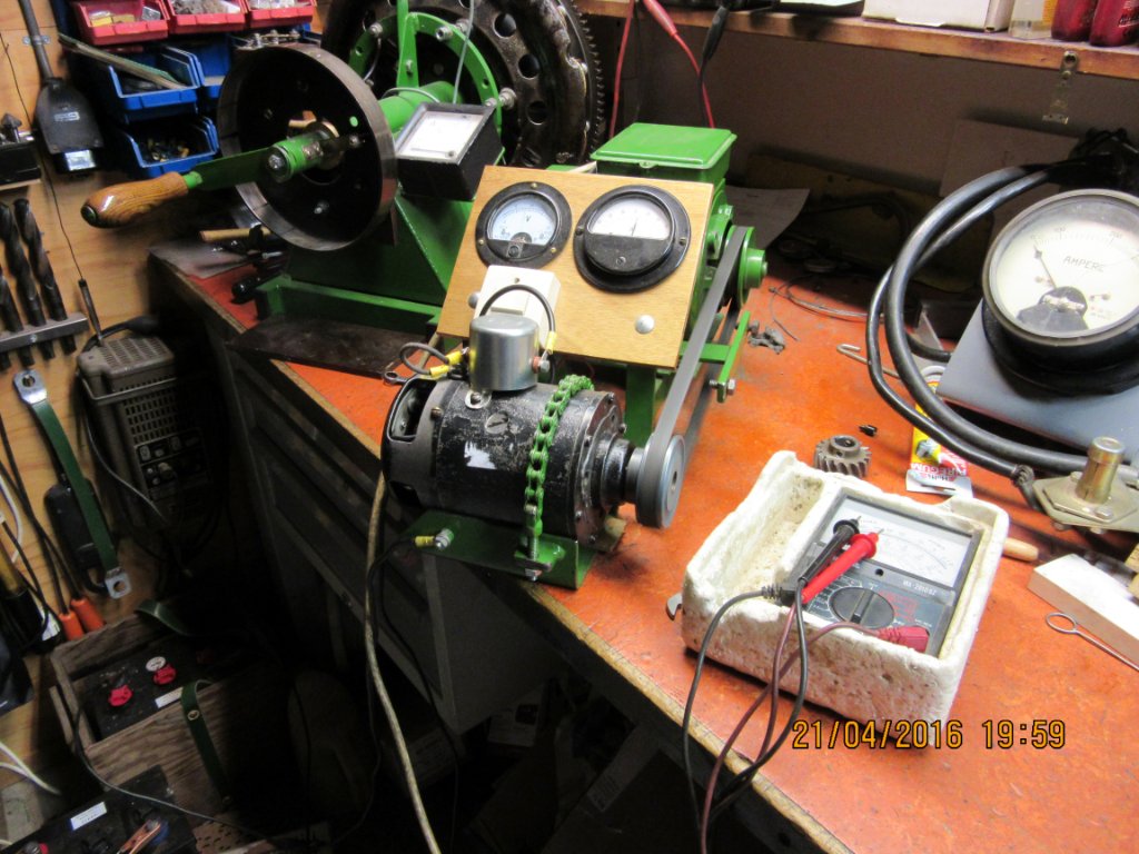

Post by ABoer » Mon Jun 06, 2022 5:23 am
Here is what I use .

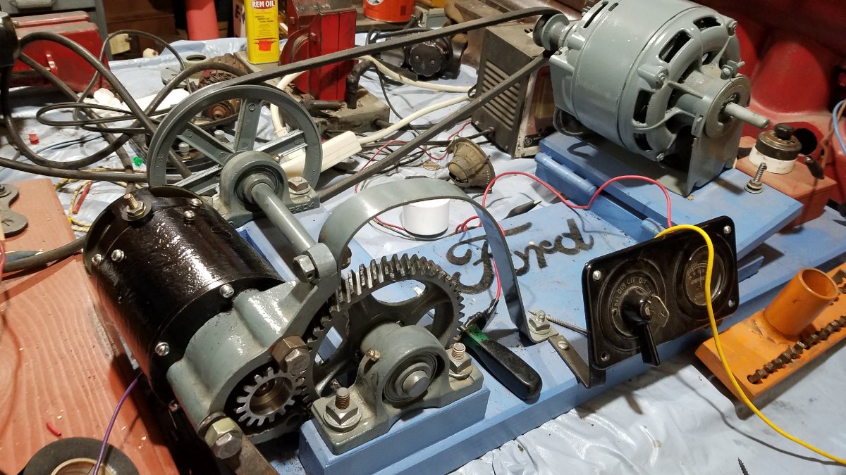

Post by Plankhill » Mon Jun 06, 2022 8:33 am
I made this one out of a generator bracket, an old timing gear, jack shaft, and old appliance motor.

Post by Scott_Conger » Mon Jun 06, 2022 1:46 pm
Brendan, in an age where we give prizes for just showing up, I think you deserve a STATUE for creativity. I love this on several different levels! :D
