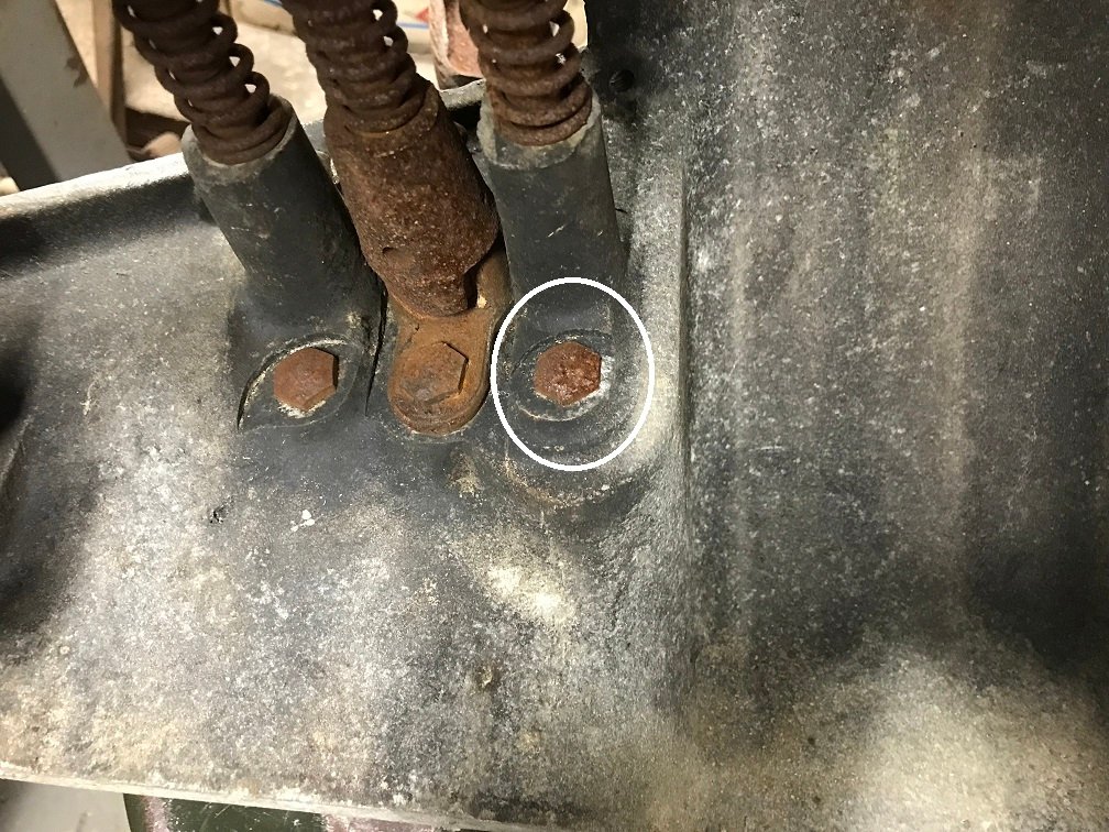

There is a camming mechanism that the reverse pedal acts against that is bolted to the hogs head. Snyder's calls it the pedal support. I am losing a nontrivial amount of effective pedal travel because the bolt is lose. Is there a secret way to tighten this bolt that doesn't involve removing the reverse band, pedal, probably more? I can get to the nut on the outside, but can only feel the bolt head on the inside.

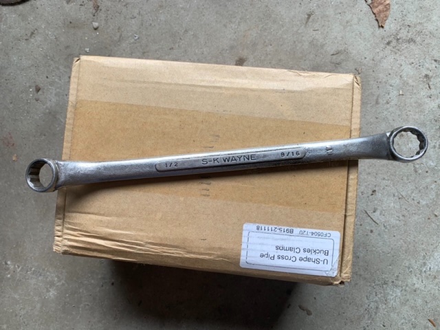

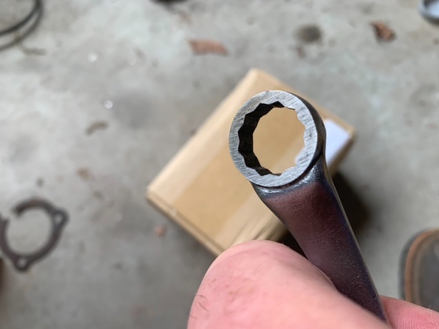

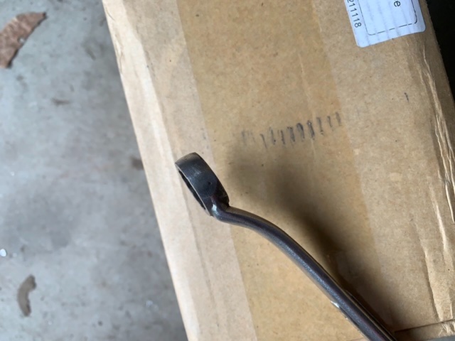

Take a long box end 12 point wrench, the one that has 9/16” on one end and 1/2” on other. Grind the 9/16 side flat, no rounded left to the bottom opening. You need it square to the world. I have reached them with this but you may have to remove the band. Not sure if you can get in there with band on.
If you want pictures of wrench let know. Dan

Since I was in shop today and using the wrench I was talking about. Here it is.
Modified end
Hope this helps someone. Dan
