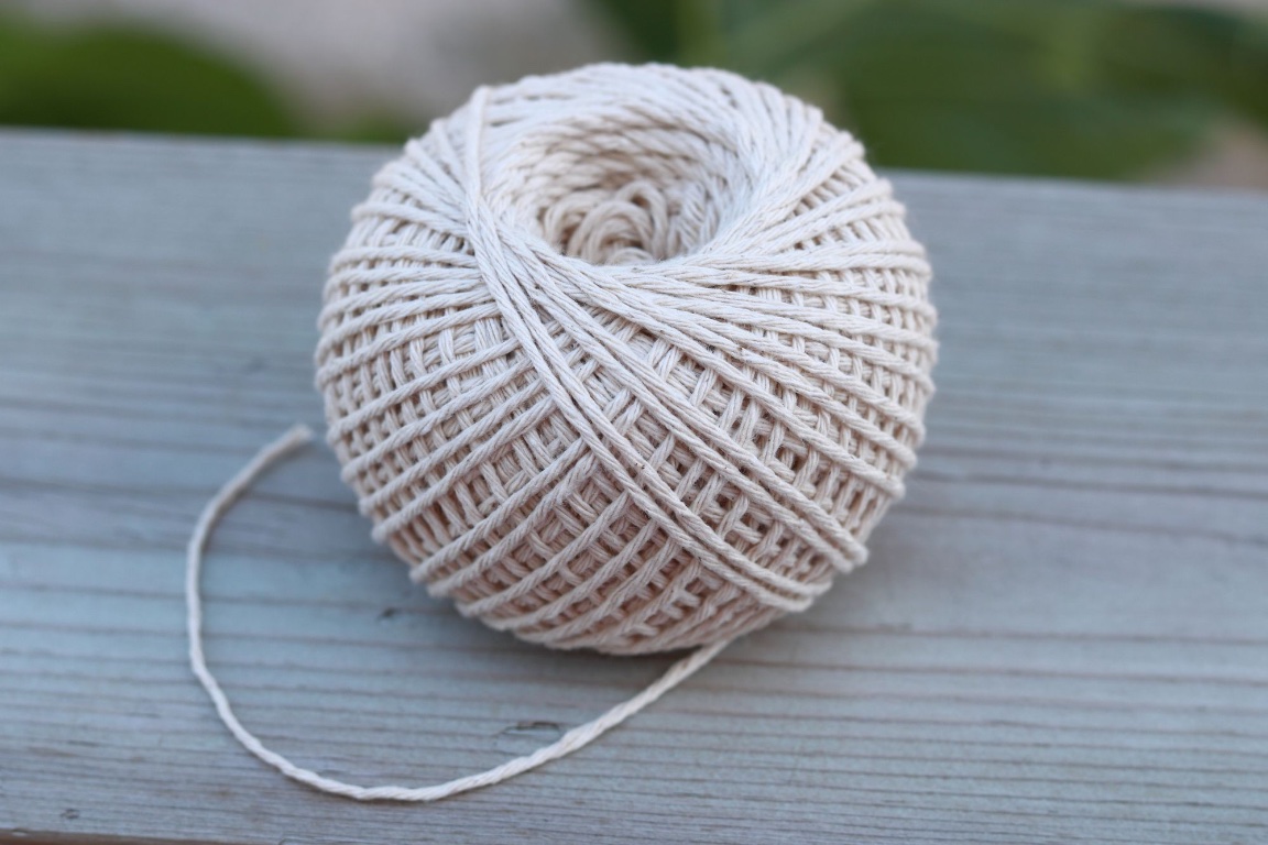

Post by John Heaman » Fri Jun 10, 2022 10:39 am
I use string.

Post by George House » Fri Jun 10, 2022 1:08 pm
Very good Scott. Typically great advice from you. And I use feed sack string too, John, with 4-5 wraps around the bolts of the bottom pan inspection cover. 😁🇺🇦
