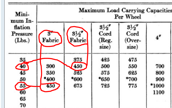

Posts: 4112
Re: Clincher air pressure?
Post by DanTreace » Tue Jun 14, 2022 3:42 pm
Here is what Ford stated.
55 psi for clinchers, 30 x 3 1/2". Normally put in 60 and don't let it fall past 55 for safety.

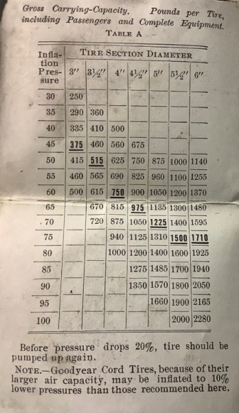

Post by Steve Jelf » Tue Jun 14, 2022 4:27 pm

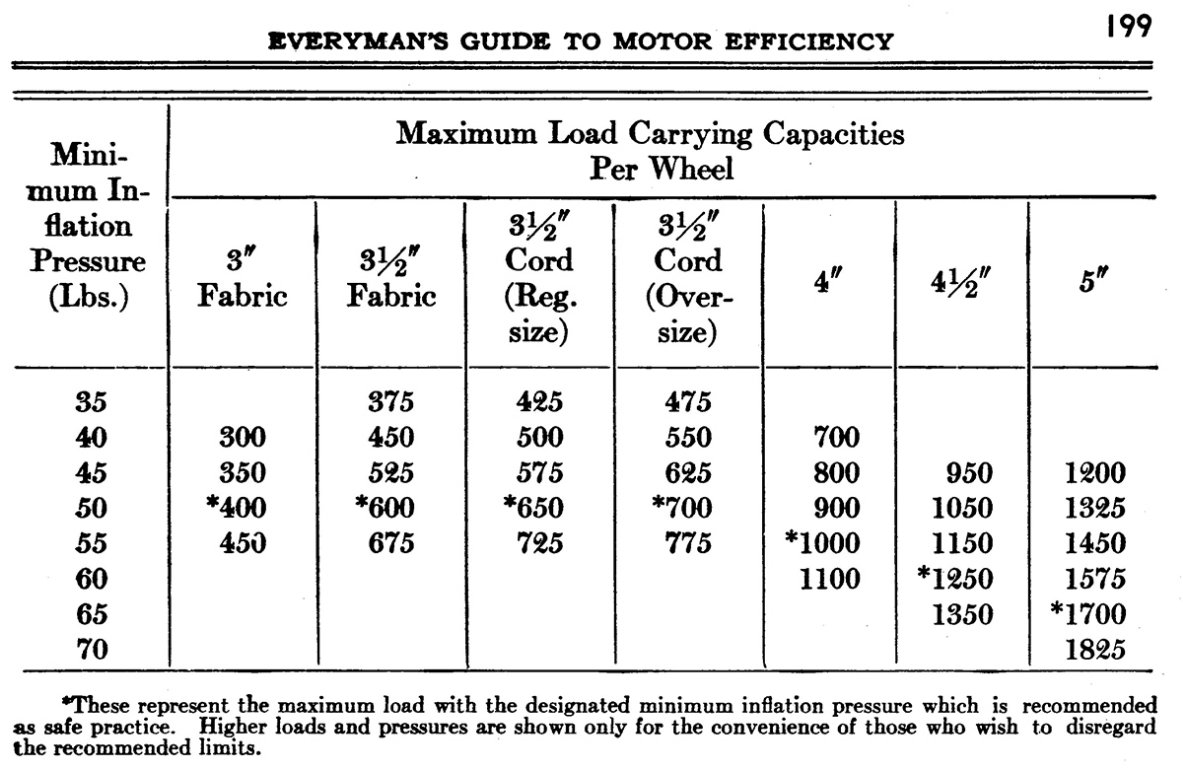

Seeing Dan's illustration, I recalled that Bruce's encyclopedia comes with owners' manuals for all years. This is from the 1915 book.

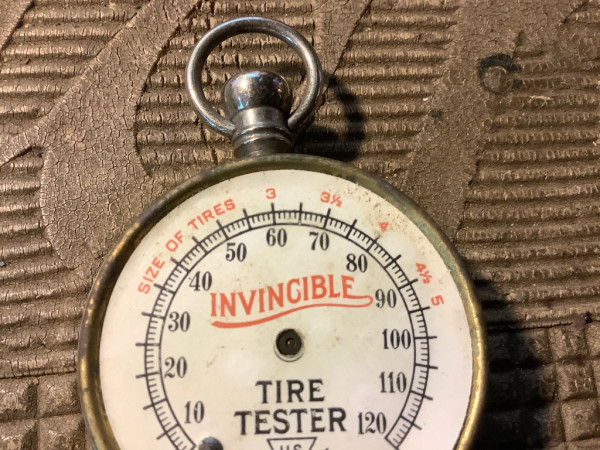

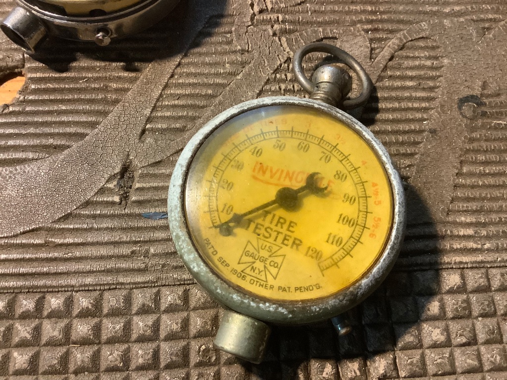

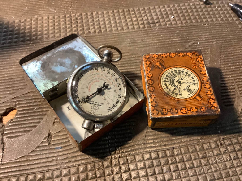

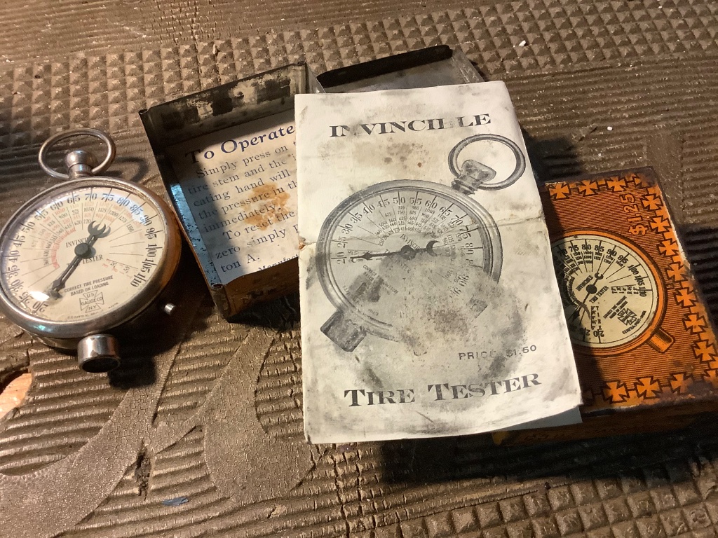

In the first couple years of motoring, you would want to purchase this tin litho encased beauty. You would then need to do some serious ‘ciphering’ before heading out.
Dropacent
Posts: 3384
Last Name: Morsher
Location: Norwalk Ohio

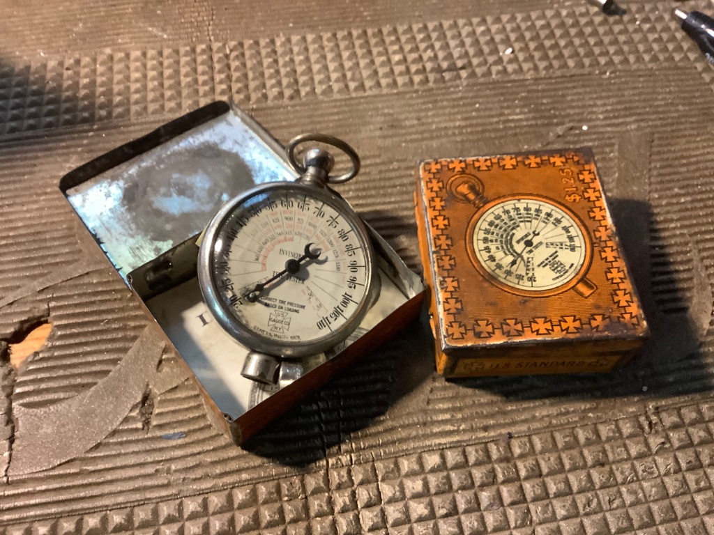

Post by Dropacent » Tue Jun 14, 2022 5:10 pm

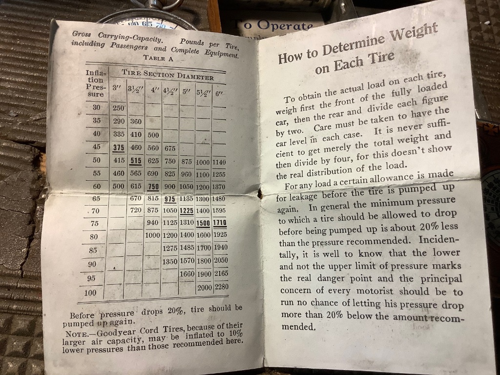

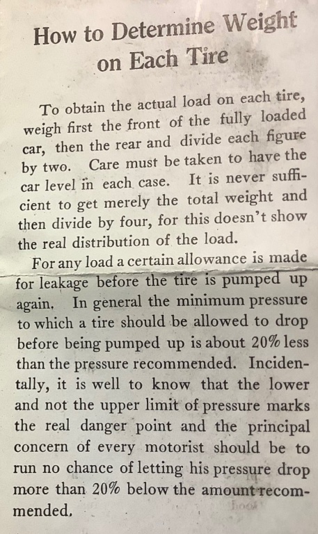

By the time of model Ts birth, things got a bit easier, at least to US Gauge standards. 60psi for 30”, 70psi for 30x3 1/2 . The invincible was patented in 1906 , so just perfect for the early T.
Less is almost always more.

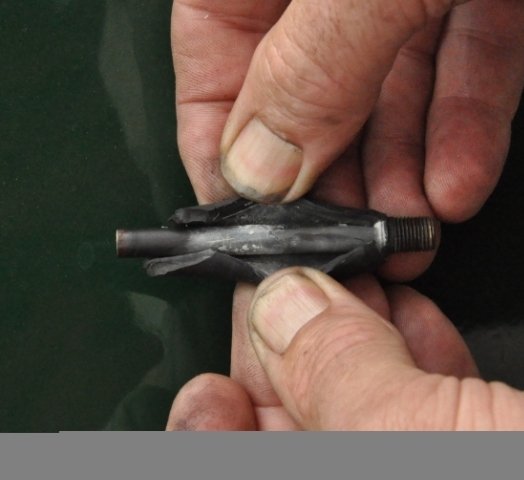

The tire rotating & shearing the valve stem is most common with powder coated rims.
That slick surface must be scuffed for more bite on the tire.
Retro54
Posts: 590
First Name: Andrew
Last Name: Blaydon
Location: Middletown
Post by Retro54 » Wed Jun 15, 2022 8:48 am
I would assume that using a metal valve stem, bridge washer and retaining washers @ the rim would protect against tube rotation and that most of the shear issues are coming from using rubber valve stems. Is this a good assumption? I've been running mine at 55-60# with no issues as of yet.
Fair assumption. The metal stem locked in will stop the shear.
You want to have some talc in the tire case. If the tire does move a bit, no harm.

How are we coming to the conclusion that the skinnier 30 x 3 tires, (fronts), need less air pressure than the 30 x 3-1/2 tires, (rears)? That runs counter to everything I've ever heard about tire inflation. By this thinking, the 21" balloon tires should have what, 100 psi? (of course not)
If we assume even weight distribution and we look at one of the charts above, we'll see that for a 450 lb. load, a 3" tire should be inflated to 55 psi and for that same load, a 3-1/2" tire requires only 40 psi. That's based on tire data from the Model T era of course. I would inflate the 3-1/2" tires to at least 50, (but wouuld scared to do 70!!).

Post by speedytinc » Sun Jun 19, 2022 4:49 pm
This chart doesnt mention clincher or non clincher. The higher pressure keeps the tire in the clincher rim. Remember also, back then clincher beads even overlapped in the middle. Todays tires do not. There is a high risk of the tire coming out of the clinch. Along comes balloon tires. Air pressure was determined by load, not a standard 32psi. Charts show much lower pressures.
Clinchers ride hard. Thats got to be why they went to balloon tires. You can get a safe soft ride. You that have both on different T's can attest.

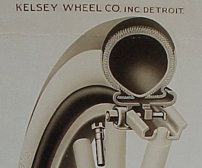

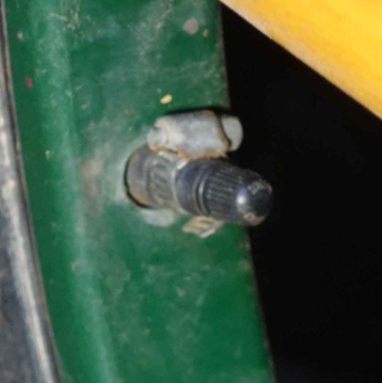

In 60 plus years of Model T driving I have never heard your statement that "back then clincher beads even overlapped in the middle" being expressed.
That seems to be a puzzle to me, how would one ever be able to put the valve stem into place if there was overlap?
Years ago we had tires which some cut the area around where the valve stem was so it enabled easier placement of it when replacing the tire and tube but if the edges of the beads actually overlapped the tube with 60 psi it would fail pretty quick I would think.( my opinion)
In the 1970's we had BE tires which came with a feather edge at the end of the beads which required trimming to prevent the thin rubber cutting into the tube on the Rolls Royce's I was involved with ( at that stage flaps were no available ) Here are two illustrations which show period cross section drawings of beaded edged tires which clearly show a space between the two beads when in place on the BE rims. Looking forward to you to show us that there were tires which overlapped.
kelsey12 Close up.jpg (42.78 KiB) Viewed 7036 times

The beads NEEDED to be notched for the valve stem. If you tear down older clincher tires you will see the difference. War vintage & earlier. I dont know when the current tire mfg's decided to change a venerable design.
Posts: 7316
Post by Allan » Tue Jun 21, 2022 9:12 am
Even with the wide foot on the Olympic BE Tyres we used to be able to buy, there was room for the valve stem, metal or rubber, to fit between the beads on 3.5" rims. The notch cut in the bead is a reflection of the tyre fitting method used. If you fit one bead first, when you go to put the tube in, the fitted bead is drawn across the valve stem hole, when you pull on the tyre to get at the valve stem. So you then cut a notch in the bead to be able to get the valve stem down the hole.
If you fit the tube in the tyre and then fit BOTH beads into the rim at the stem hole, and lever both sides on at once, they is never any need to notch the beads.
I know many tyres were notched. That does not mean that notching was essential. It is even less necessary on today's skinny beads.

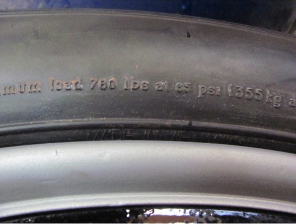

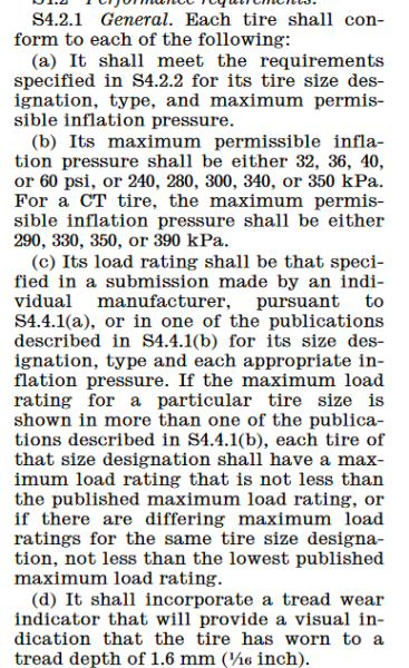

Post by TRDxB2 » Tue Jun 21, 2022 11:54 am

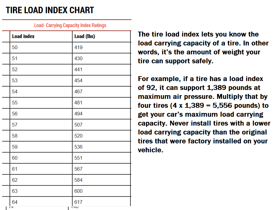

Today's tire construction and material is quite different than those made in the past. So using 100 old pressure charts arn't likely to be applicable. Current DOT laws https://www.govinfo.gov/content/pkg/CFR ... 71-109.pdf
Example
Tire pressure.png (418.09 KiB) Viewed 6905 times
Load Chart https://www.tiresplus.com/tires/tire-bu ... dex-chart/
So what's it say on your tires - values vary by brand so its not one value fits all

Here is a photo taken of such a valve stem cut open, note the chalk powder along the metal tube and the right hand end of the stem where the thread begins, the white mark is the small vulcanized seal of the rubber to the metal stem. That happened on the Pincher Creek tour in 2011, The immediate fix was to put small clamps around the valve stem on the other tubes below the threaded end. I still have one on a wheel 11 years later holding air. The best answer is obviously to replace the rubber stems with metal ones which everyone has intimated before.
