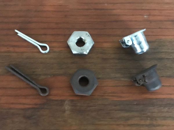

The pieces I have worked on are a zinc plated cotter pin, a raw nut, and a zinc plated oiler.
The photo makes the bluing look better than it is, they are gritty with rust. I am using Birchwood “super blue” which was advertised as being darker than their standard bluing.

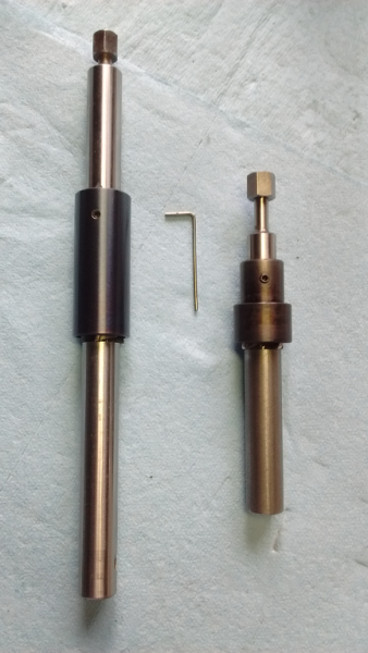

true "bluing" is an oxide conversion coating on steel. As the steel is heated hotter and hotter, the oxide coating changes in thickness and reflects a number of colors, including purple, light blue, dark blue, brown, etc (not necessarily in that order) until it goes back to a silver color. Once the color you desire is attained through heating to a known temperature in an oven, or, the heat is removed (if a torch) and the part is dunked into oil, the color stops changing and an infinitesimal amount of oil is absorbed into the oxide layer. If you live in FL, the coating is very fragile and requires periodic coating with oil to remain rust-free. In WY where it is dryer, you can handle the part to your heart's content and it will be rust-free for almost forever so long as it is not subjected to moisture/perspiration and even at that, if wiped dry will remain rust-free.
Cold bluing on the other hand is an entirely different process and depending on the chemicals can be more or (far) less resistant to corrosion. With respect to blueing a zinc plated part, the color is not on the steel, but on the zinc. I have no experience with this, but suspect that using the chemical on the wrong material may be some of your undoing.
As an aside, blueing is not a heat-treatment per-se for steel when defining heat-treatment as altering the metallurgy of the basis part...you never want to heat-blue a tool that has to cut something as the heat required exceeds the tempering temperature by a significant degree...it will make the tool unuseable. That said, I heat blue much of my own tooling where aesthetics and mild rust-resistance are important (to me) and where hardness is NOT important to me.
when using cold bluing, or heat-bluing, surface condition and scrupulous cleanliness is paramount for the most pleasing and predictable appearance...a matte finish will give a dull/dark finish while a polished part will give a very lustrous finish when done
these two tools show the difference in amount of heat applied vs the color that resulted. They were made years ago and just taken out of storage to help another "T" guy with details of their manufacture...they still look like the day they were made

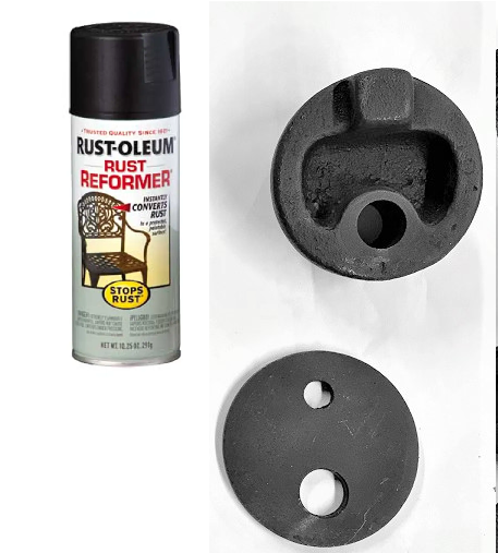

You might want to look into this Rustoleum product RUST REFORMER about $5 - not to be confused with their Rust Inhibitor
"Stop rust in its tracks with Rust-Oleum® Stops Rust® Rust Reformer. A layer of this flat-black coating bonds with rusty metal and instantly transforms it into a non-rusting surface. No need to sand down to bare metal, simply spray directly onto rust."
rust reformer.png (201.97 KiB) Viewed 2815 times

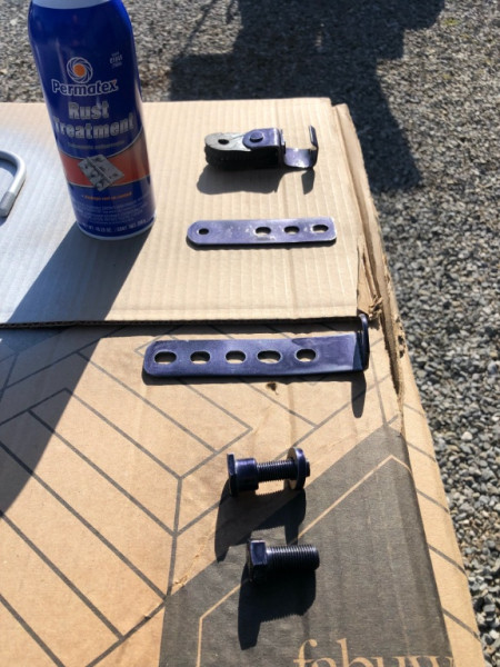

Very clean metal, warmed in the sun, multiple coats gives a nice appearance which is elements resistant. I only use this brand as it holds up.
To each their own!
