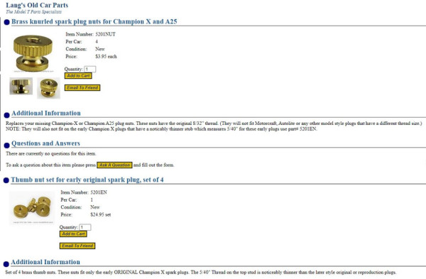

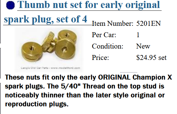

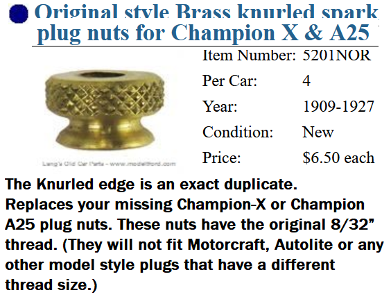

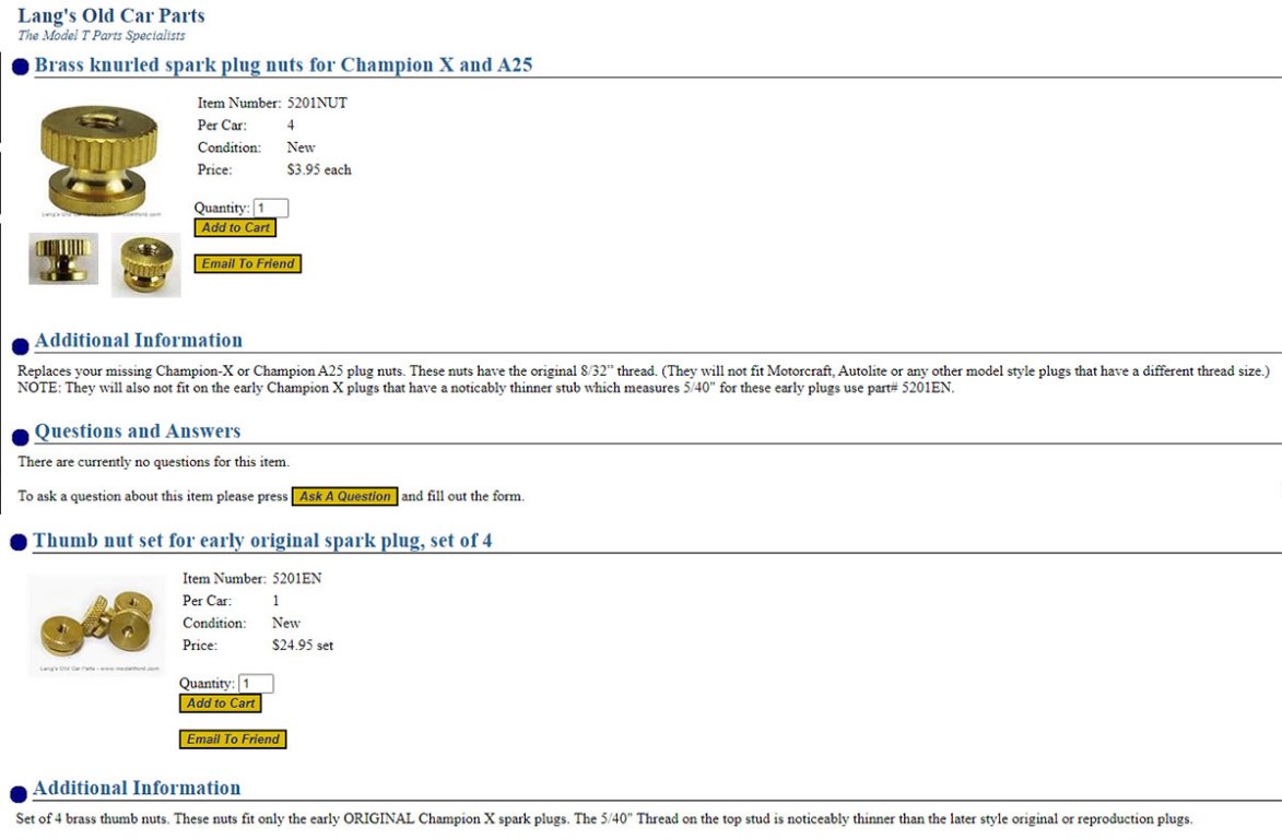

If I may, here are 2 cuts from the Lang's site. They do offer the #5-40 as well as the #8-32 if these are still available.
They seem to be made out of Brass rather than unobtanium as we had thought.

Mein gott! $6.24 a nut! I believe in supporting our parts dealers, but I'll spend the money on things I can't get elsewhere, especially when elsewhere is a fraction of the price (71¢ on Amazon). I love Lang's, but not for plug nuts.

I feel your pain Steve. $24.95 hurts me more than $6.24 a nut.
I might make some if I needed but I'm not using those plugs in anything right now.
Still, I was delighted to see they weren't impossible to find. I wouldn't make them for less money to sell.

Not sure what you found on AMAZON but not all knurled nuts are alike. Lang's is selling original style nuts for those seeking originality. --Steve Jelf wrote: ↑Wed Jun 15, 2022 11:21 pmMein gott! $6.24 a nut! I believe in supporting our parts dealers, but I'll spend the money on things I can't get elsewhere, especially when elsewhere is a fraction of the price (71¢ on Amazon). I love Lang's, but not for plug nuts.![]()

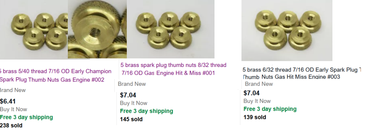

For the rest who are looking just for a functional solution and are content function over form there are other choices.
I found this seller on ebay - has several items (ignition wires etc ) for hit-mis engines that could be used on a T Considering free shipping and a close knurl design plus one spare
https://www.ebay.com/sch/i.html?_ssn=zk ... c=1&_pgn=1
