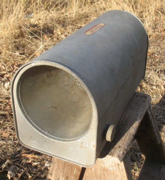

Auto air coolers used to be a common sight when I was a kid. They were a big cannister type device that fit in the vehicle side window and were held in place by the window. You put water, or water and ice in them and they had some kind of pad-like lining that absorbed the water. The road draft or a small fan would push air through the unit and into the car. They probably worked very well in Arizona and West Texas. They never worked very well in more humid areas, and I doubt if one would be much good in South Texas unless you kept putting ice in it . Dry air and higher elevations aided evaporation, and thus cooling. I think these may still be available somewhere. Old ones most all limed-up and rusted away years ago. If you can find one, you could probably install one on a T sedan or coupe. Driving 20-30 MPH with one in the passenger side window and the driver side window rolled down about an inch or so would provide a cool cross-draft.

Try searching 'auto evaporative cooler" or "auto swamp cooler". The devices I am thinking of look sort of like a small jet engine attatched to a vehicle's side window. I foound a bunch of pictures of different ones installed in various old vehicles by searching "auto evaporative cooler" on DuckDuckGo.

the old evaporative coolers for cars did work well here in dry Colorado ... usually put in the front passenger window and would open a rear window just enough to get a flow thru effect ... would go thru several gallons of water a day ... always an optimist ...Gene French

Have you tried one of these? 1941 Plymouth, Arizona desert. It was in the right front window. Mom may have gotten a little cool air, as she was sitting right beside it pulling the strings to keep the cloth wet. But my little brother and I, riding in the back seat, were dying of the heat.
