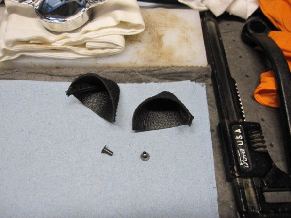

connect this little bugger through the leather pieces into the lower hood ends. I do not have any tool small enough to flatten the little supplied rivet.
Any input would be great and Thanks in advance.

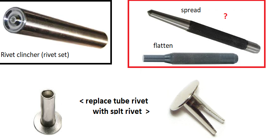

Support the rivet head on a buck, use a center punch to flair the rivet, then a ball peen hammer to form the mushroom.

The proper tool is a rivet clincher. It is designed to role the edges of the tube rivet over (used on Model T ignition switch rivets). You could try to use a some punches, one to spread the tube and the other to flatten - chance of success about 40%. Or just replace the tube rivet with a split rive (washer optional).

Note….You don’t rivet them on the way they come out of the package. They are folded where the rivet goes through 4 pieces.

Thanks for the pictures and that piece of paper work...I used to have that somewhere when I opened the package last year, per usual just getting to it now. I will try Langs ect for that rivet punch.
