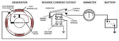

If they are coil type, yes. The coil wound type do not care what polarity is grounded. The ones shown, are just a cut out not a regulator.

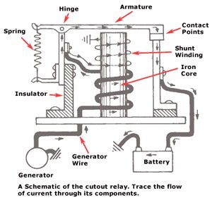

I think you are not clear on the differences. A simple explanation.
The original style cut out is an electro-mechanical switch. It has a set of points. When the Gen produces a bit more voltage than the battery, the electromagnetic closes the points for electricity to charge the battery. When the gen is not producing enough or the motor isnt running, the points open so that battery power doesnt feed back into the gen to ground shorting out.
An electronic cut out is a diode that allows electricity to flow one way to the battery from the gen. No points or mechanical stuff to fail.
A voltage regulator, REGULATES the gen output. It feeds power to the battery only what it needs to maintain the proper voltage level. It must be built to a specific battery voltage, where as a diode(if rated high enough) will work for any battery you are using, 6,8 or 12V.

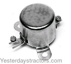

After reading the page you supplied, it appears that they are marketing a combination cut-out/vibrating point-style voltage mechanical regulator. Not something I'm prepared to put into my car.
No one in the Model T community ever offered such a device to owners. The Voltage Regulator which everyone laments the demise of, was a solid state device. This one is not.

These cheap repo cutouts are known to regularly fail & destroy your generator.

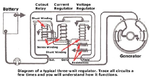

NOTE: The current (amperage) is regulated, 3rd brush, inside the Model T generator. That is why many 6volt VR don't work for a Model T. Also the Fun Projects VR just the works the cutout and voltage regulation functions
These images are just to show what is being managed in a VR versus a cutout in a typical system - not a Model T http://www.secondchancegarage.com/public/83.cfm
- Attachments
- vr image.jpg (31.58 KiB) Viewed 3346 times
- Posts: 8653
Re: Are these the same
Re: Diagram of 3 element regulator and generator: Note that the generator has one commutator brush grounded and the other brush brought out to an external "output" terminal, the same as a Model T generator. However, unlike the T generator, which has one end of the field circuit grounded and the other end (manually adjustabley) connected to generator output via the internal "third brush", the two brush generator has ****ONE ** end of the field circuit connected to the ungrounded (output) brush and the other end brought out to an external terminal, rather than being grounded. This allows constant, automatic regulation of the field current, and thus of the generator output. Field current is sourced directly from the generator output and regulated by inserting resistance between the field circuit and ground. Regulating field current directly regulates generator output.

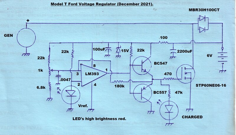

"In recent times (end of 2021), there has been a lot of interest on the MTFCA forum about voltage regulators, since the Fun Projects regulator is in short supply. It has certainly been a popular accessory over the years, and from all reports, as well my own experience, it works very well. With some encouragement from forum members Mike Kossor (the designer of the ECCT, E- timers, and I-Timers), and Luke, a fellow electronics and Model T enthusiast, I decided to finish my project."
And going from Something simple like this:
And something complicated as this pic of an electronic voltage regulator:
And I am beginning to see how, for me, all the fun of owning and operating a Model T is fading.....
