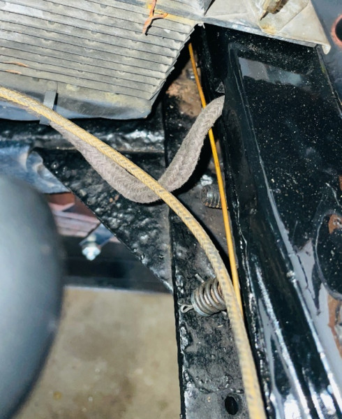

Where does the headlight wire from the back of the headlight bucket enter the car on a 1926-27 Model T since there is no hole in the hood shelf for this year?

Under the hood shelf just behind the radiator. Should be a clearance notch on the bottom side of the metal hood shelf and on the wooden block.

As Jeff wrote:
