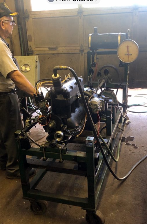

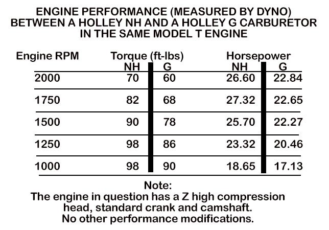

Today I picked up my engine after a transmission rebuild. As "proof of life" the rebuilder set it up on a Dyno and ran it for me, first with a Holley NH, then with my Holley G. I have a NH at home in a box that I've never gotten around to installing on the engine. Based upon the results, I think I will now

That's a pretty good set of figgurs....

I was going to put a correct G on my 1915, but those numbers have me reconsidering. A cleaned up G sure is pretty, but I don't know that I want to give up four or five HP.

Steve, don't overlook that the engine has a Z head. The difference may not be as great with the standard head on a 1915 model.

Also, Charlie Volkening made up these neat graphs showing the performance curves of the two carbs.

And the Holley G may have been a tired carb too.

I seriously doubt an NH will make 5hp difference, but a dyno test could prove me wrong. I picked up just over two HP when i went from a standard NH to a straight through NH on a 14-15 high volume cast iron intake manifold. The extra 5 hp came when a Z head was fitted. So many variables in any combination!

All I can tell you is that they ran the two carbs back to back on my engine. Their swayback NH and my Holley G - both using standard manifolds. The Dyno readings were taken within minutes of each other. Attached is a photo of the dyno in action.

I drove my Model T with it's "new" Holley NH today. Right out the gate it was obvious the car had more power and faster acceleration than with my Holley G. I was even able to accelerate going up a hill that I normally am lucky just to hold my speed (or not lose much.) I'll know more after I get a few more miles on it but so far I'm pleased.
