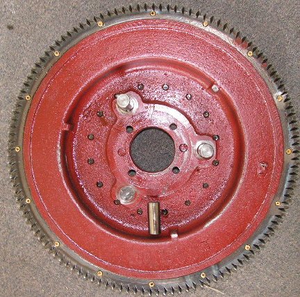

That happened to me about 20 years ago.
There were complaints at that time about a different combination of te bushing materials that made them swell when hot and not shrink again when cold.
This one just tore into.

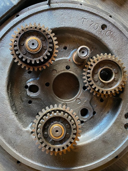

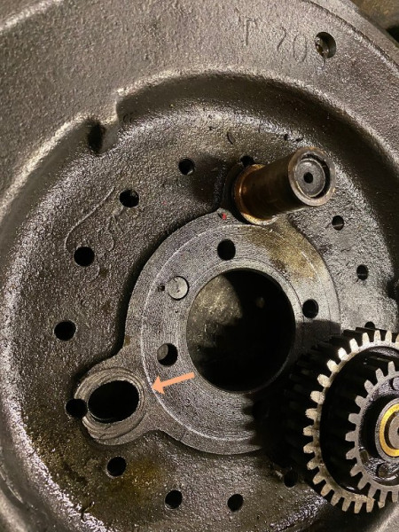

Thanks to all of you who have shared your experiences and observations. I finally found time to drag the damaged triple gears out of the box and look them over more closely. It is obvious that the bushings locked upon the pins. It appears that the gears were spinning on the bushings (and eventually spinning at least two of the pins). I have to wonder just how long this was going on before it failed? All seemed to be fine until I tried to back up a little incline and something let loose.
I never suspected such a thing was a problem with Model T's but from the other postings I see that it is more common than I would have thought. My confidence in the car has dropped a few notches and I suspect I'll be listening very carefully to any new noises the car makes.
I've attached a better photo of the flywheel and the triple gears. Two of the pins spun out, one of the gears game off the bushing which is locked to the pin.
