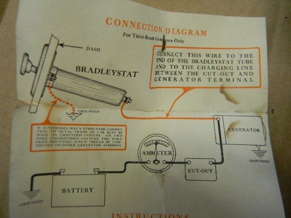

Putting resistance between the cutout and battery will cause the generator voltage to increase as it tries to restore the same amount of charge current it produced before. Not only might this damage the windings in the generator, but assuming a mechanical cutout, the voltage coil might burn out. The generator is a constant current device. A shunt resistor can be used between the generator terminal and ground to divert a certain amount of charge current, but it's inefficient. At least once commercially made device did just this:
A more efficent control is a resistor or rheostat in series with the field coil.
(Setting the charge current to 25Ah as suggested in that article is way too high)
Best option is to simply set the charge current to 5A and leave it. A conventional wet lead acid battery won't be damaged by that amount of current.
And let's get rid of this fallacy that the battery must always be charging when the headlights are on - there's 50 to 100Ah of capacity in the battery. If generator charge current is 5A, and headlights draw 7A, then only 2A is pulled from the battery, and there's a lot of hours before the battery is discharged. Who, in a Model T, drives for hours upon hours, night after night?
Posts: 8664
Re: T Generator
Post by TXGOAT2 » Thu Jun 30, 2022 9:33 pm
The Bradleystat does about what turning on the lights does. Is it correct that grounding the output terminal completey disables the generator? If so, adding a switched ground connected to the output terminal of the generator would work for me. I assume the generator would retain enough residual magnetism to ramp up without further attention once the ground switch was opened. I also assume that closing the ground switch with the ammeter indicating 0 charge or a discharge would not result in fireworks.

The grounding switch certainly works; it's the principle behind the various electronic voltage regulators. Since the generator's field coils are powered from the output terminal, they are unable to produce any magnetic field (above that from residual magnetism) with the output terminal shorted to ground.
However, the grounding switch should only be used with solid state diode cutouts. The reason being is that the mechanical cutout actually provides a direct connection between the generator and battery when in operation. If the grounding switch is closed while the engine is running above idle, the battery is effectively being short circuited to ground, for the short period it takes for the cutout contacts open. If one remembered to only close the ground switch with the engine off or only at idle (when the cutout is still open), then it could be used this way.
I remember one car in my club with a grounding switch and mechanical cutout - the owner complained of blowing the battery fuse when the switch was operated whilst driving.
In the case of the diode cutout, the diode is immediately reverse biassed when the grounding switch is closed, so the switch never sees the battery current.
