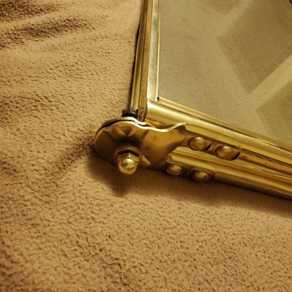

RGould1910
Posts: 1151
Last Name: Gould
Location: Folsom, CA
Re: Question about hardware for brass Rands windshield hinges
Post by RGould1910 » Sat Jul 09, 2022 1:14 am
Brass plated bolts on the 1910, screws on the 1912. Both Rands windshields. Photo shows the 1912.
