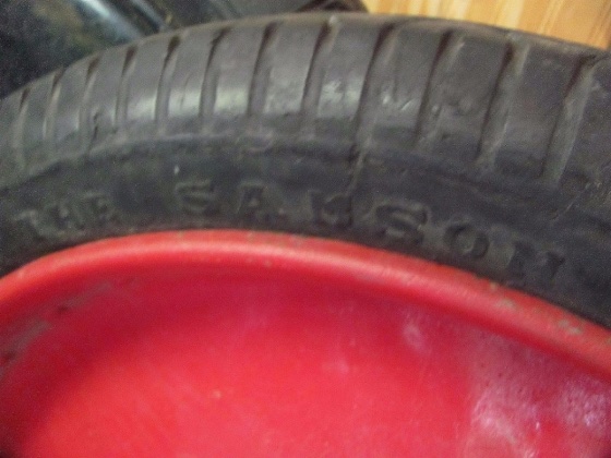

Universal T-Driver's are good tires, last a long time too.
The tread pattern and sidewall are 'period' too, like the famous Samson Tire, similar sidewall bars.
Old Samson

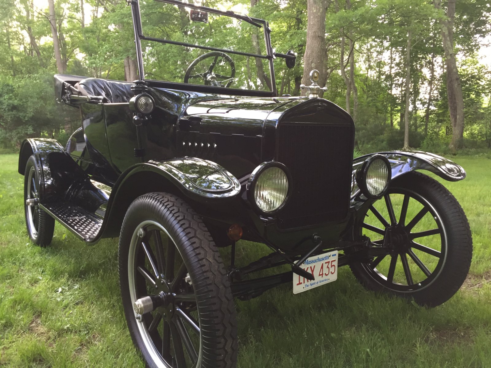

IMG_1003 (640x480) (560x420).jpg (100.27 KiB) Viewed 9404 times

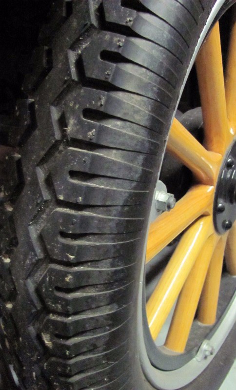

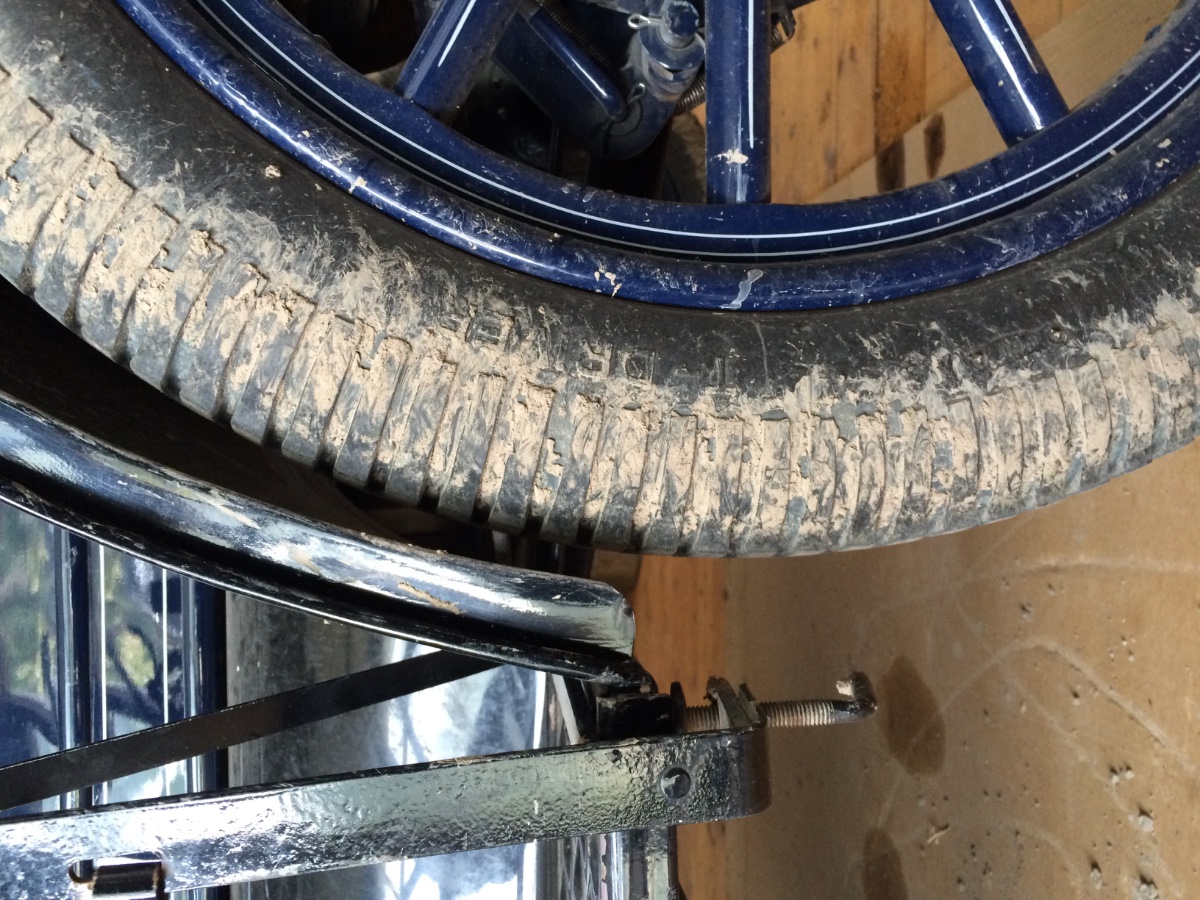

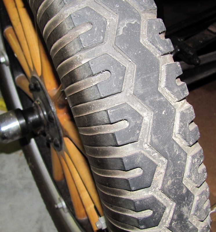

Univ T-Driver about 18 years old, still good tread, but that aged rubber is much stiffer now, affects ride and grip.
Replaced with new T-Driver. Nothing beats the improved ride from a set of new , soft , fresh rubber tires ;)

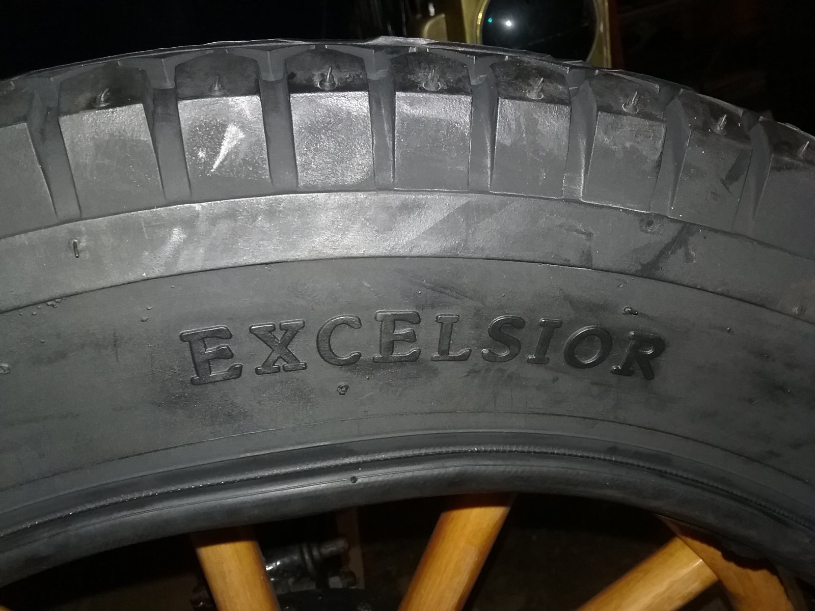

I have purchased, but not yet mounted Coker Excelsior tires for my 1911. They are not the cheapest tires around, but they are NOT oversize. I will post pictures when I get them mounted.

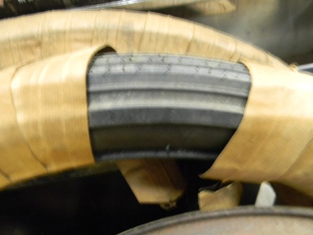

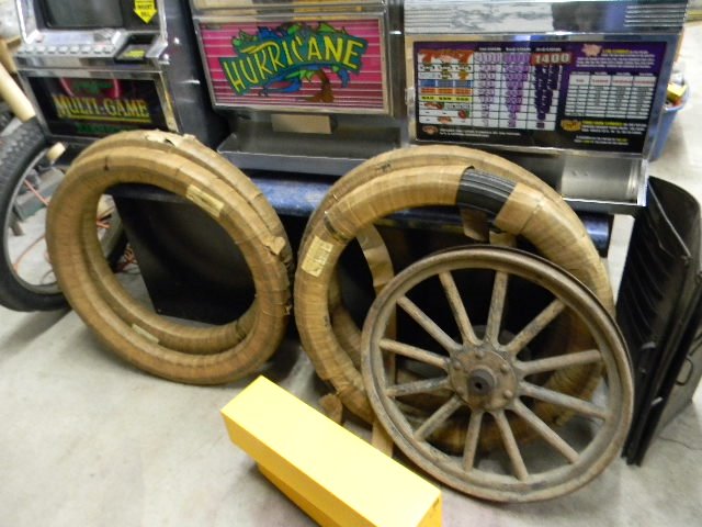

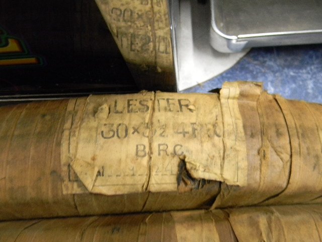

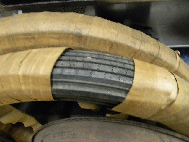

When I bought the 3 Model T's from the museum I also bought all the parts and with that I got a new set of Lester 30 x 3 and 30 x 3 1/2 tires new still 9in the brown paper nice and soft if you want a deal call me, Bob
Posts: 7411
Re: My old 30 X 3 1/2 tires
Post by Steve Jelf » Fri Apr 12, 2019 11:16 am
Bob, have you looked at the date codes on the Lesters? My experience with NOS tires was that they were gorgeous, like new, when I unwrapped them, but they didn't last long. That demonstrated for me that rubber deteriorates with age, just sitting on the shelf.

I believe the Excelsior tires are from Viet Nam.

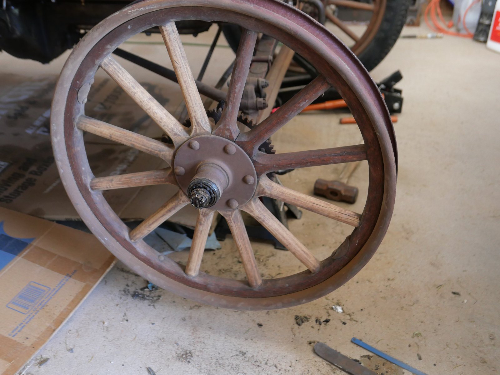

In the mean time I need to replace a rivet and refinish the spokes and rim.

In my opinion, Excelsior 30 x 3s look the best and more period correct because they are not so bulbous as the other brands of 30 x 3 tires.
The 30 x 3.5 Excelsiors are oversize like all the other brands of 30 x 3.5 tires.
If your wheel has a loose rivet, that may be an indication that your rim is loose around on the felloe. It is the pressure of the rim against the felloe that keeps the rim on the wheel. The rivets help keep the rim centered, but they should not be relied upon to keep the rim on the wheel.
You may want to consider removing the rim, shimming the felloe and then heating the rim and shrinking it back on.

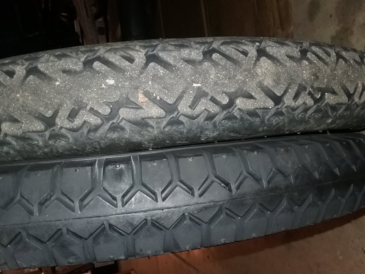

I know that these tires are not exactly the subject of this conversation, but they will fit on some Model T’s.
Has anyone had any experience with these?
I am looking forward to hearing your response.
Matt

I have a set of Excelsior tires on my '25, and they are huge, bigger than oversize. They've been on for nearly ten years, and are getting little cracks all over. I wouldn't buy another set.

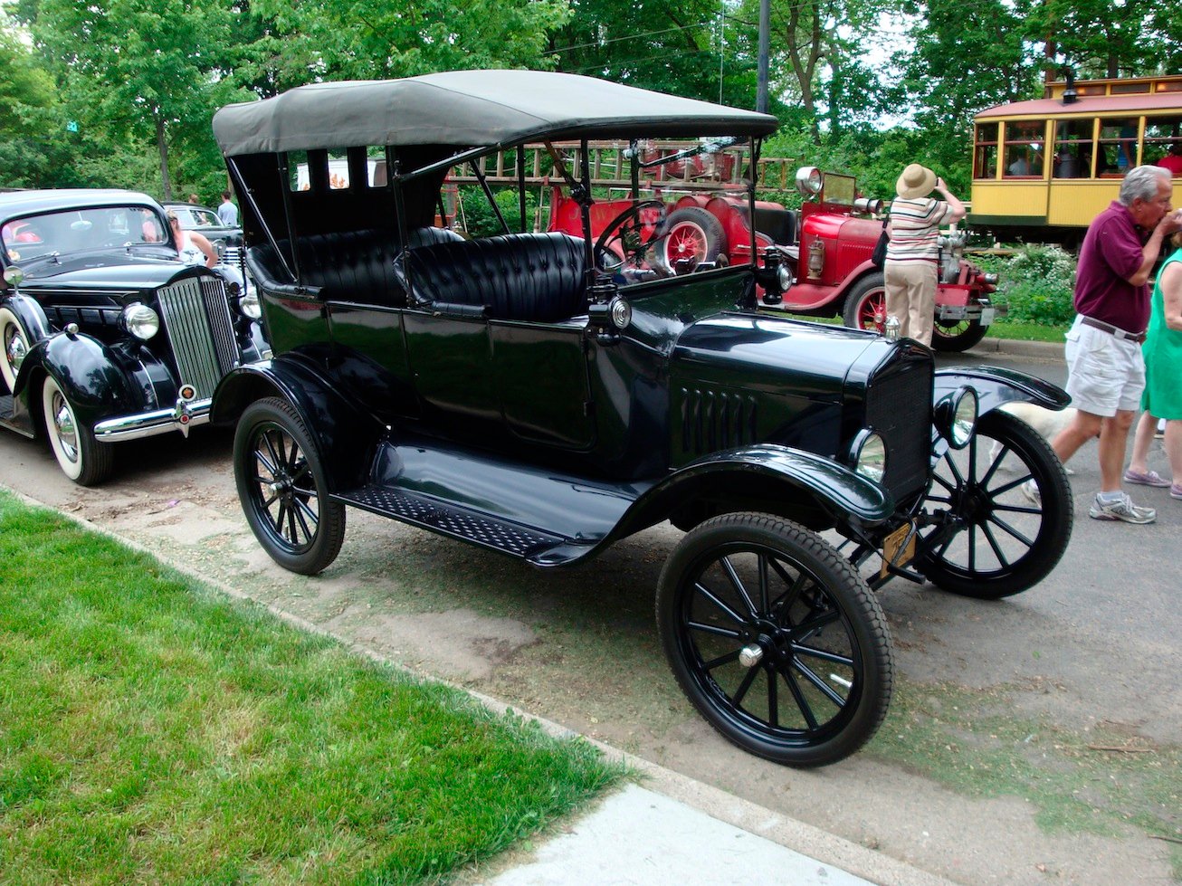

My dad has Coker Commander tires on his 1917 touring. They are about 20 years old. They do not have any checking or cracks.
Commander tires are now called Excelsior.
The reason he bought them is the 30 x 3 tires (front tires) appear to be more period correct as they seem to have a narrower profile and do not appear oversize and bulbous like the other brands currently available.

Erik, the Man Who Owns One wants you to move. :D

I''m trying to remember who owns that Packard.
