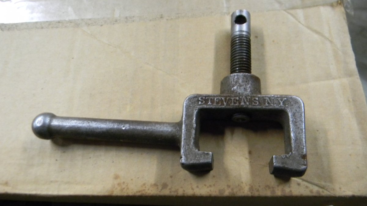

What is the proper puller to use to remove the gear on the generator? This is on my '26.

Post by FATMAN » Fri Jul 15, 2022 9:42 am
This is the correct tool that I use, Bob

Would most any puller work?

Post by A Whiteman » Fri Jul 15, 2022 10:18 pm
Only if they have the clearance for the legs to fit between the housing and the gear.
