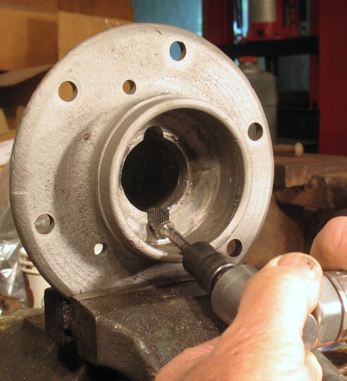

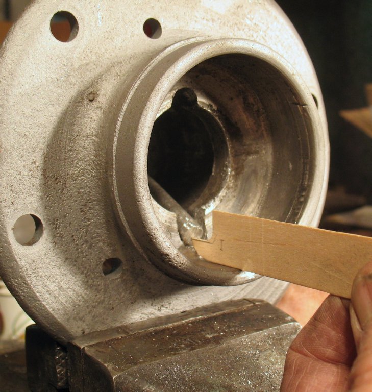

- Posts: 6805
Re: Question about front wheel bearings
If you still have the original hubs with ball bearing races, the corner transition from ID to "bottom" of the area in which each race seats will have a generous fillet as machined. This is where folks get it wrong: the ball bearing race has an even more generously relieved corner and it will seat in the hub with no problem. New races will have nearly square corner transition from it's OD to "bottom" and will almost certainly seat prematurely, and forever stick out too far and even risk getting permanently installed cockeyed. You will almost certainly have to carefully grind a similar generous radius on the corner of all races so that they may fully seat with no interference. Even then, you will likely find that the outer race sticks proud of the hub by something like 1/16". That's OK. Because of this slight extra length between bearings, the vendors sell a hardened "thin" keyed washer to go over the threaded bearing and under the nut. It is a little spendy, but works nicely and allows the original nut to sock down at the correct depth and let the castellation(s) align with the cotter hole in the axle shaft. If you were/are a machinist, you will have radius gauges and can check the hub fillet and easily know that you have ground the race sufficiently to clear. If you're not so equipped with radius gauges and I realize most are not, just go by the radius on the back of the old race and try to emulate it. Obviously, go easy and don't overheat the race. I find that an endless belt sander does a very nice job of it.

- Posts: 7411
Unless you are extremely lucky in a parts search, Timkens are practically mandatory. Some ball bearing parts seem to be made of unobtainium. There's no problem with Timkens until you have to remove the cups from a hub made for ball bearings. The ball bearing cups have a higher profile and you can easily drive them out from the other side with a drift. A drift can't reach the lower-profiles Timken cup in an earlier hub without notches.
