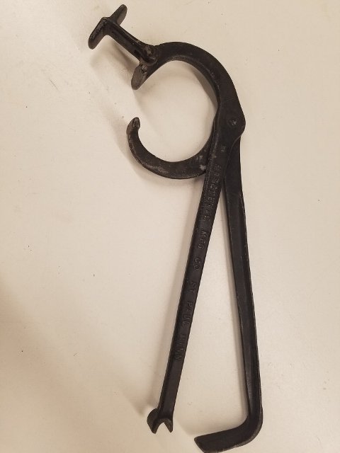

Can anyone explain the correlated usage of the Marquette tire tool? I understand the bead breaker application, but the other parts of this tool are unknown. Any help would be greatly appreciated. Thank you.

Here is the detail instructions:
https://www.mtfca.com/discus/messages/1 ... 29203.html
The tool has two ends, the taking off tire end has a ‘swivel hook’ that levers against the rim for pulling off the tire.
