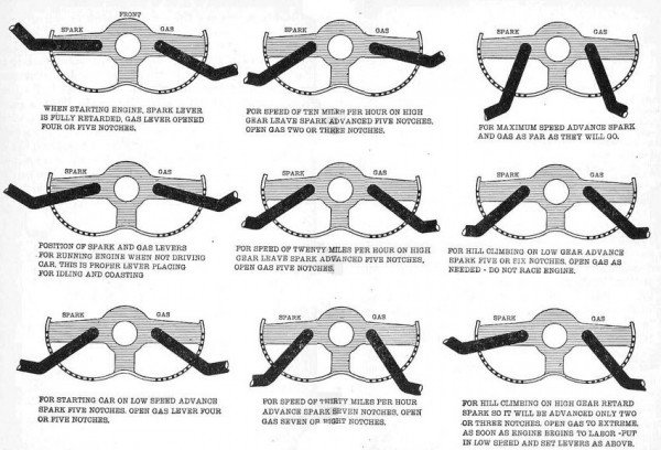

quadrant positions.jpg (65.73 KiB) Viewed 8650 times
Moxie26 wrote:
Sun Jul 17, 2022 8:59 pm
Do you advance your timing when you go out for a ride or keep it retarded?.... The cooling system takes approximately 3 gallons.
Running without advancing timing as per chart, and not getting at least 20 mph of speed to force air thru your radiator will make your car overheat. Stop and go traffic in hot temps will make the car run "warm..."

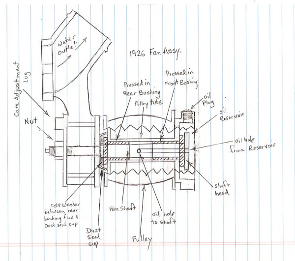

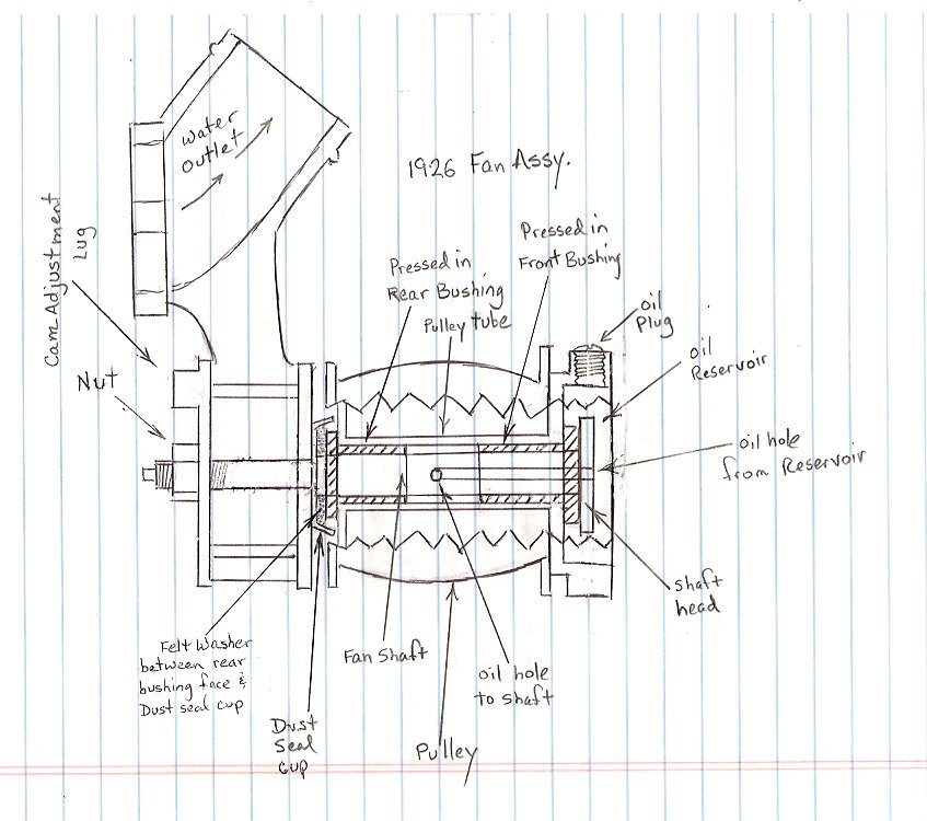

Lisa. As soon as I posted my question as to what year your Model T was, I read in the title of your post that it’s a 1926, so I deleted the part of my post asking the year. Anyway, congratulations on finding your First Model T. I have a 1926 coupe. We look forward to a picture of yours.
The 1926-‘27 Model T has a different fan assembly. Be sure to add motor oil to the fan reservoir (located just aft of the fan), so the fan can turn properly so as to cool the water in the radiator. The shaft from the reservoir to the space between the bushings is hollow so as to deliver oil from the reservoir to the space to lubricate the length of the shaft. Jim Patrick

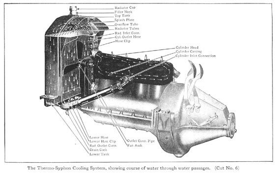

Also, does anyone have thoughts on the outlet connection pipe being the issue? Changing to brass (3939BR)?
Posts: 3743
Last Name: Wrenn
Re: 1926 T Running Hot
Post by TWrenn » Mon Jul 18, 2022 10:04 am
Lisa, I doubt changing the outlet pipe will do anything, unless of course it's got a lot of restriction or even plugged up.
I didn't catch anyone (I just "skim read") asking if you have a round tube or a flat tube radiator? Round tube rads do not cool well.
And, any old rad, round or flat tube, just may need to be taken to a radiator shop and have it boiled out. Often that cures it. Likewise, now we're getting into more work and the shortage of head gaskets, but maybe some of the tiny little circulation holes in the head or the block have suddenly plugged up. It's always a possibility. Start with cleaning the radiator first.

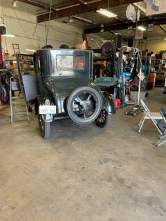

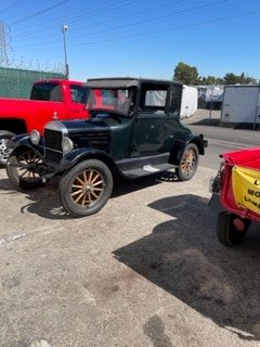

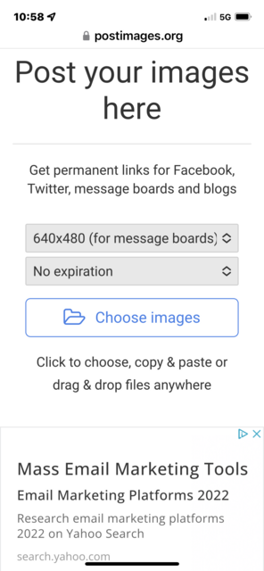

Jim, I just attached some pictures. No matter how I adjust or rotate them they still come sideways. Sorry! I will try to upload the video later. I LOVE my car. I just need to figure out what the root of the issues are and why now...ie if they are interrelated. Being new to the T and mechanics in general I am finding the learning process SLOW - hence my many outreaches to you all.

I use “ Postimage” for uploading jpegs to sites and they always came out sideways until I chose the 640x480 size for the pictures. I also choose the “hot link for forums” option.
Using a real (not phone) camera I have had the sideways problem only with vertical format photos. (Recently people have started calling this the "portrait" format.) I have found that if I rotate the picture 90º either way and then rotate it back and save, it will show up here with the correct orientation. I don't know if that will work with phone pictures.
You can post nearly all photos here without reducing them in size. The website does that for you. Very rarely I get the dreaded yellow triangle telling me the file must be reduced. I ignore the numbers it gives me. I reduce the photo by a pixel or two and it posts.
I tried the rotate/rotate-back trick with your photo.
I also blew it up a little over 250%. That makes it bigger, but doesn't make it any sharper. The ability of software to sharpen photos is very limited. It's better to shoot the original pictures full size.

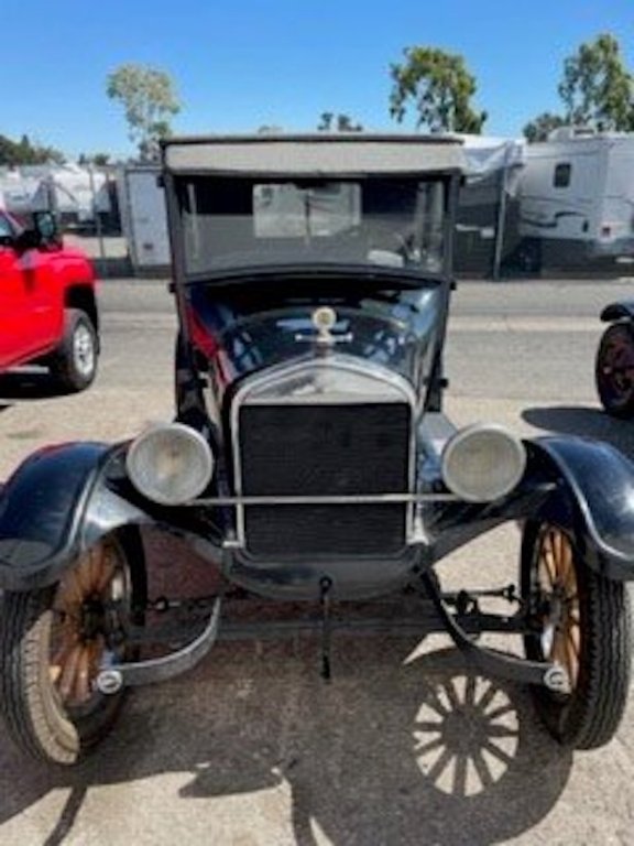

They are indeed phone pics - but properly oriented. When they arrived at my office (I emailed them here because I wanted to get them to Jim because he asked)....they arrived sideways. I save them in proper orientation and they reverted to the side shots. I then tried to save the previous pictures I saved properly rotated and they again reverted. LOL. So I figured I would deal with it after work tonight but fulfilled my goal of getting them to Jim.
I will follow all instructions on the attachment tweaks for next time. Thank you.
Back to the overheating - I will see if we can flush and do all the remedial options. If I have to go to new radiator I will. Just odd that it started up now immediately after the starter fix. Car had been perfectly fine. Oh well, That is how things happen....one after other!
Posts: 8664
Post by TXGOAT2 » Mon Jul 18, 2022 12:46 pm
Judging by appearances can be deceiving, but judging by the looks of that car, it's probably in pretty good shape. The fact that it only recently showed signs of overheating, and then after running at a standstill for about 20 minutes, suggests to me that it probably does not have serious issues. Get the starter problem out of the way, then make sure the radiator is full of coolant, fan belt adjusted properly and go drive the car, taking care to manage the spark and carburetor settings. Carry a couple of gallon jugs of water along. If it does overheat, a simple garden hose flush may suffice to correct it. Other possible problems that could contribute to overheating: 1. Brakes dragging when moving due to faulty adjustment. 2. Transmission bands dragging due to tight adjustment. 3. Thermostat, if present. (?) 4. fan mounted backwards. (?)
Pat, it actually is in great shape. The Long Beach T guys looked it over thoroughly and gave their stamp of approval. I trust them IMPLICITLY. They are good guys. It is not a pretty pretty looking car but it runs well and idles very very very nicely. That is all I want - I don't need pretty but do want it running well. I can get better pics if you like. The car was likely subject to an old restoration in the 70's or 80's - that is my guess. It is also my guess that the car was garaged for quite a few years before the Estate sale the previous owner bought it at. It was a time capsule of sorts. The 1971 graduation tassel hanging on the rearview mirror was unfaded and in condition that made me think it was not hanging off the mirror long before it was garaged. It looked as if it was just placed there and not subject to direct sunlight. The radiator issue worries me less than the starter issue.

Steve. Take a look at the engine drawing in my above post and below. Unless the Model T era diagram is wrong, the pipe going from the bottom of the radiator to the engine block is listed as the “outlet pipe”. The inlet pipe goes from the head to the radiator. No big deal but I just wanted to let you know in case it matters to someone else. I suppose It only matters if we are attempting to give advice to someone. Jim Patrick

Very Nice! Here are your pictures righted and cropped. Mine is a ‘26 coupe also. I have had mine for 52 years. Jim Patrick

It is the radiator outlet pipe, but it's also the engine water inlet pipe. I've always thought of the lower hose as the inlet, and the upper one as the outlet.
jiminbartow
Posts: 2485
Last Name: Patrick
Location: Bartow, FL
Post by jiminbartow » Mon Jul 18, 2022 10:17 pm
From Ford’s perspective and the way I have always understood it, the outlet and inlet refers to the water entering and exiting the radiator, not the water entering and exiting the water jacket of the block. Snyder’s and Lang’s also refers to the lower pipe as an outlet pipe. It really makes no difference to me what members call a part as long as it does not cause confusion to those seeking help. Respectfully submitted. Jim Patrick

Part #3939: The Ford parts book calls it the outlet connection pipe. I called it the inlet because that's where it connects, but I'll use the ford designation to avoid confusion. It's the pipe connecting the radiator outlet to the engine inlet. :)
Outlet from the radiator - inlet to the radiator.
