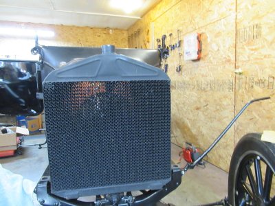

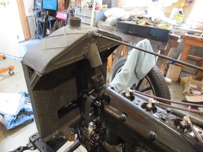

here are a couple of pics of my honey comb. I tested it and it doesn't leak, water inlet had been reinforced with brazing at some point but tank and connections are solid.
Thanks for the input Van

I've been running a period honeycomb replacement rad in the '24 Speedster for 30 years. Cools just fine, no complaints and this car is not babied. For normal flatland driving I can run the car without the fan belt. I developed a leak in the upper right honeycomb several years ago and plugged it by pumping 'Right Stuff' into the offending cells.

Thanks guys, I will give this a try, certainly has visual appeal and as this is a non starter car that was converted to starter not going to worry about the looks. Just wanted input of how well it works.
