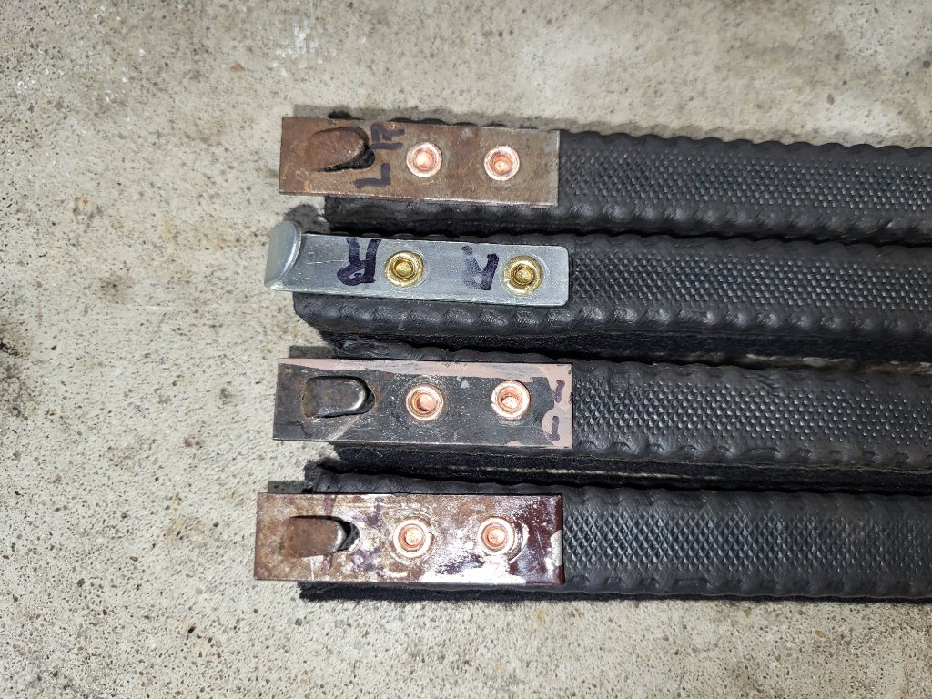

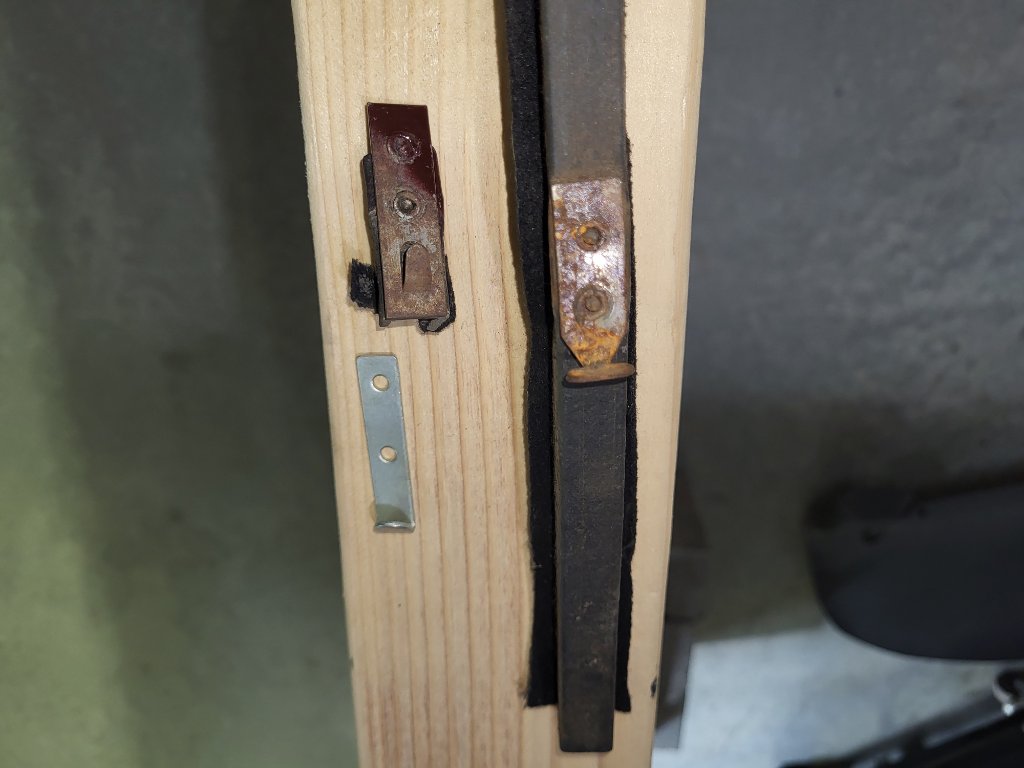

Jim, The felt channel was not riveted to the retaining channel on my 1927 coupe. It held in place by the clip at the top and the clip at the bottom that are shown in the attached photo. The was no evidence of any adhesive.
Some one told me that adhesive should be used. I had not intend to use any adhesive because it takes some time to get the felt channel hooked in at the top and bottom, and the adhesive is tacky enough to prevent the piece from being moved around while trying to get it hooked.

Rivet the top and bottom clips to the top and bottom felt channels as originally done. Whoever told you to use adhesive is wrong. If you have the original felt channel (never throw away old parts until the job is done), line the original felt channel up with the new felt channel and drill holes in the same place on the new felt channel and rivet the clips on. Make sure you get the top and bottom correct and be sure to rivet the clips with the tops and bottoms correctly positioned so they will slide into the channel holes properly. After 51 years, It is coming back to me. Instead of pop rivets, you will need to use hollow rivets so they will fit flat to the clips, as pop rivets are not flat on the backside.
Attached are several photos of the hollow rivets you will need and the special punch used to brad them. The photos are from McMaster-Carr of Atlanta, GA. Go to www.McMaster.com and type “hollow rivets” in the search box and choose the size you need. Be sure and carefully read the tutorial on all of the hollow rivets that are available and how to measure them so as to order the correct rivets. Jim Patrick
PS. I would carefully drill out the rivets and re-use the original clips. When you drill the rivets out, drill only the rivets, then punch them through with a pin punch. Do not drill new hole in the clips. Notice how the rivets on your original clips look identical to the hollow rivet “bottom” photo.

I have attached some of my clips using split rivets, but I ran out of them. After seeing your information, I thought maybe I should attach the remaining clips using hollow rivets or maybe replace the split rivets that I had already installed.
I looked up the McMaster information for size etc. and also the special tool needed to install them. The Tool cost is $55, so I guess I will stay with the split rivets!

I used hollow rivets as Jim Patrick recommended.

Jahn, I used 9/64" diameter x 0.25" hollow-body rivets from McMaster.com. They also have hollow-end rivets.
