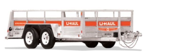

Rent one of these 6 x 12 utility trailers from UHaul $35.00! Both a stock T and TT fit perfectly inside. Been there. Done that numerous times.
