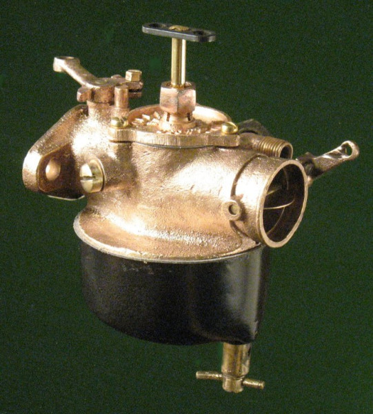

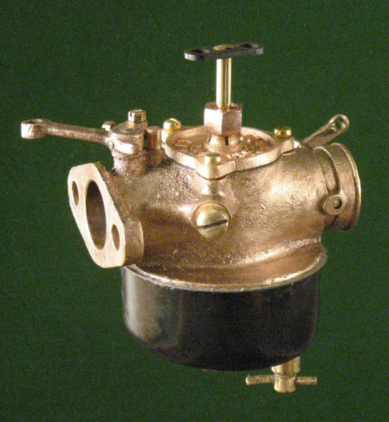

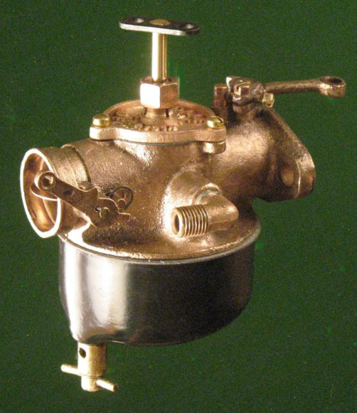

Post by Steve Jelf » Sun Aug 07, 2022 12:46 am
Here are a few more G photos. They do clean up nicely.
Note the flange around the hole at the choke end of the carburetor. Some have that and some don't. I prefer it as it's helpful in mounting an air filter.

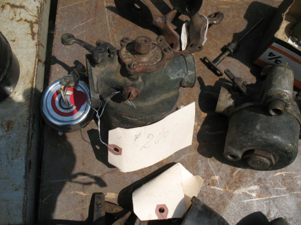

Years ago at Iola I saw this G that was desperate for cleanup and repair. I asked the guy why the price was so high. He said, "Why, that's a three-screw carburetor!"
