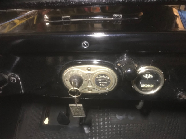

The needle on the ammeter on my '27 moves to the charge side when the lights are turned on and the engine is off so I reversed the wires but when I reversed the wires the lights don't go on and the needle doesn't move. I put the wires back the way they were and the lights work again and the ammeter still shows positive when the lights are on and the engine is off. Is the ammeter bad? I would assume that if it works with the wires one way it would with them reversed as well. Any suggestions?

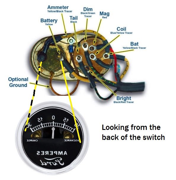

An ammeter isn't grounded unless it has an internal bulb that is connected to a switch. AGAIN the ammeter is connected in series (minus to plus) to the electrical system to indicate the current load on the system. The terminals in the back need to be connected correctly such that when the indicator arrow moves it matches the face plate as charging or discharging. So as the wiring diagram goes one terminal is from the generator and the other to the battery. When these connections are correct the arrow should show a negative reading with the lights on if non-led lights are used regardless of the engine running or not. It should show a positive reading with the engine running and the light off.
The ammeters current behavior is an indication that it needs to be replaced. It is likely that something is restricting its movement to the negative side of the scale Replacements are available most everywhere. If not I have repros & originals that I'll be glad to sell you
