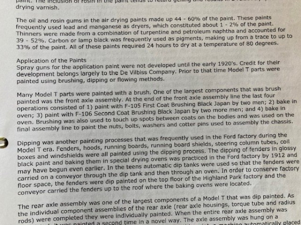

Robert, this may be more detail than you want for your project; attached is a picture copy of a section of Trent Boggess' article on Model T painting. In the 3rd paragraph he references brush painting nuts and bolts black during assembly.

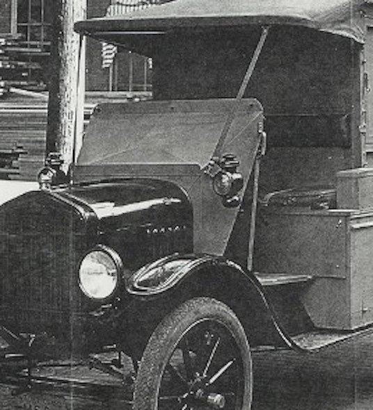

This is one photo example of a new ambulance and show factory shiny black on chassis, hood, and fenders, would think all the fasteners too are black painted as they were done on the assembly line and painted to finish.
And the rest of the wood body assembly is painted up military style, and you can see clearly the carriage bolt heads on the wood panel of the seat base are painted same color as the body.
