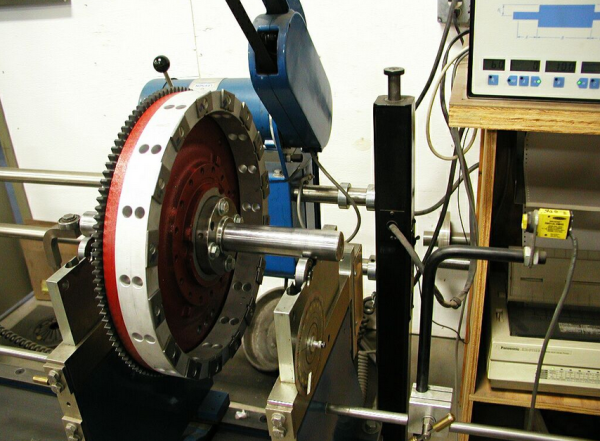

I am seriously considering making up a flywheel with the aluminum "magnets" and operating it on my motor driven HCCT just to see how it might perform. Do any of you metallurgists have any recommendations on whether to attempt to bend the bars or weld them at the junction of the poles and do you have any thoughts on what type of aluminum might be best for the experiment.

I recall a post some time back where someone had created an all aluminum flywheel with bored pockets in the face, and modern hockey-puck magnets pressed into each cavity. This was intended for operation at engine speed and temp, but since the hcct turns slower the mounting would not need to be as strong. However, by the time you figure out how to attach P-Magnets to the C-Iron flywheel, and set the gap, an all aluminum flywheel may be the simplest. Maybe an aluminum disc (~1/2" thick??) with holes for magnets centered over the keeper screws and 4 holes matching 4 of the magnet hanger bolt holes would be a starting design? Spacers between the disc and flywheel at the 4 hanger bolts would set the magnet pole face to stator coil gap and I doubt you would need any keeper screws. Light press fit dry? or slip fit magnets into holes in plate and some loctite to secure?? Good luck with your project, jb
And there have been some good posts on the strength of the modern puck-type magnets necessary to excite the magneto, and I can't locate that either. Before you get too far along, I suggest determining the 'strength' and composition (ceramic vs metal) of magnet needed and building your holders to fit that particular magnet. Temperature rating of magnet in service obviously is not an issue with your hcct. jb
